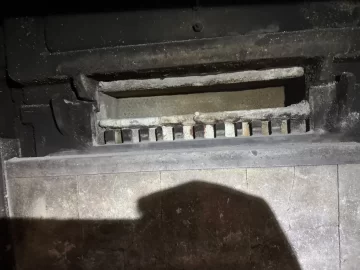

When I close/move the damper lever on the left, the damper door either goes fully open or half open. Never fully shut. The lever also doesn’t point to open and close markings etched on the side of the stove. Making me think that the linkage has come out of alignment. I cleaned around the damper door and found bunch of broken/stiff gasket. It moves freely now but still stuck between open and half open. I can also pull it closed with my hand by holding the screw in the middle
There’s no gasket now, but that’s the next project once I could get the door shut.
Is there a way to remove the damper door completely and realign the linkage? Am I not looking at this right?

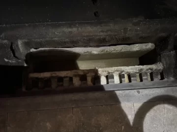

Undid the chimney to get access to the back. Looks like the linkage went beyond the two knubs. I just held the door down with one hand and gently rotated the linkage with the other hand to seat it over. It now seals and the stove is finally doing more than a fire show!!!
Although, the refractory looks a bit weird after cleaning all the ash sitting in the top 😭 or maybe this is how it supposed to look?
