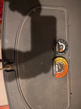

The digital temp pho to is when it started running away while completely shut down. Air intake on back is shut, cat air intake is half plugged.
Magnetic thermo is totally out of control with the digital within a 30° lower reading.
We did notice air draw it the photo circled under the air intake on the back, Don’t know what it is. Fire picture is raging with the almost 900°reading. but no way to shut it down further.

Magnetic is on the stove behind the griddle butted near to the flue base.

That’s an important clarification, 900 degree CAT temp with it turned way down is a lot different than griddle temp!
The CATS want to run hot, 900 is a nothing burger. With the stove turned down that’s pretty normal. The CAT is active above 600, ideal Range ~ 1,000-1,300 and max around 1650 (this max is often debated here).
In my experience griddle temp seems to lag a little, so if you just turned it down it will take a while to cool off. I think VC lists 650 as max griddle temp, but I wouldn’t be worried about running a little hotter for a while… heck those magnet gauges can be off by 50 degrees.
I'm saying this jokingly.. if you move your thermometer.. you'll have fixed your stove.
900° was the stove top temp at the base of stove at the flue pipe.
Going to move it to the griddle

Most likely it's not getting to hot. Your measuring the temp in the wrong spot.. the picture you posted tell a completely different story of what's actually happening. I'm pretty sure it's running correctly.
Take a breath.. move the thermostat and run the stove, take some pictures and note the SST, post back what's going on. We're going to do things 1 at a time and not panic.

We moved magnetic therm to the griddle & gonna see what happens
