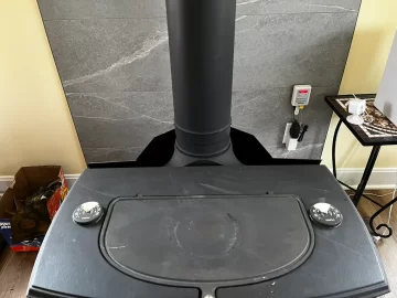

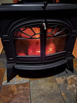

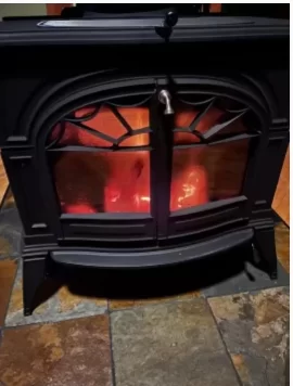

This is our brand new Defiant.1975 cat C
Picture is stove completely shut down.
Right air control is pushed closed or handle pointing to rear & Cat C on the the left is pushed closed or in the forward position.
CANNOT get this to choke down.
It completely burns out in 3-4 hours.

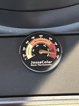

Top was 653°
Afraid to really stock it, because it goes like an inferno until it burns out.

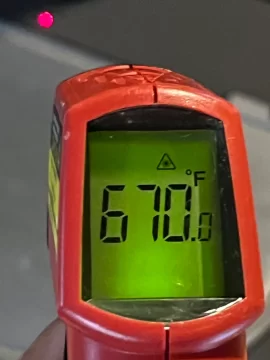

Get an IR thermometer to triple check the magnet thermometers. Some of them can be way off.

We’ve tried all of the above, our problem is the stove won’t damper down even with the air intake closed & cat is closed.
It burns like an inferno until all the wood is gone, which is usually 3-4 hours.
Hesitate on loading it up for the night, afraid l will burn the house down.

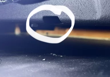

Did notice on the back of the stove the 2x4 air flow shuts when closed, & won’t draw smoke, but the 2x4 hole above it does. I assume it is the cat airflow?

I have the same stove and have also lived through all of the things you mention. What @VRB Farm said in that follow up response are all really good things to check and do. As crazy as it sounds, don't empty that ash pan. It does make a difference. I have never woke up to a warm stove but have dug some coals out of the ashes for a kindling relight. It's been a bit disappointing not to have anything more than a 6 hour burn, but we do enjoy the heat. Watch the VC 2025/2026 performance discussion or read through past years. You'll find nuggets of wisdom.
That is your secondary air intake, which feeds the cat chamber but also supplies air into the main fire box, many users have plugged 2-3 of the holes with SS bolts in the fire box to help lower the involuntary air, this has come with success. below thread has the info on this

The digital temp pho to is when it started running away while completely shut down. Air intake on back is shut, cat air intake is half plugged.
Magnetic thermo is totally out of control with the digital within a 30° lower reading.
We did notice air draw it the photo circled under the air intake on the back, Don’t know what it is. Fire picture is raging with the almost 900°reading. but no way to shut it down further.
Are you measuring the temperature on the griddle.. it's hard to tell from the picture
Also the picture of the fire doesn't look to be raging. The soot on the glass is a clear indicator of it being dialed back correctly. Also from the picture of your stove was burning as hot as your saying the glass at that point would be burned completely clean. So I'm thinking your measuring the temperature in the incorrect spot, or your thermometers are wrong.
