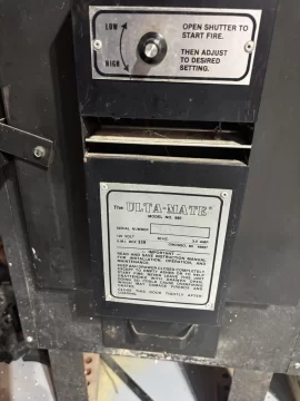

Bought a house with a Ulta-Mate model 880 wood furnace in the basement. Can’t find a manual for this unit. Need help finding a manual/operating instructions for this furnace.

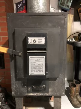

Please post a pic of the front as well. Could be very similar to other wood furnaces.

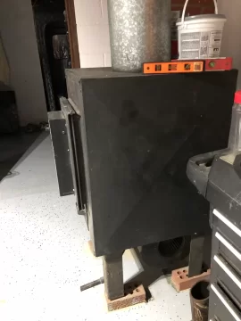

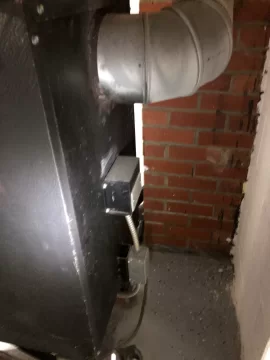

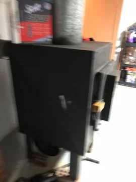

This is a wood furnace. It has a blower and the round duct is tied in to the forced air oil furnace. I assume the blower is controlled by a temperature switch but I would like more information on the unit before starting it up.
So the fellah that I know that lives near Owosso is over 80, still has a good memory, and did not know that there was ever a wood furnace manufacturer in town, or at the PO/address listed on the tag in your pic there.
That said, just from looking at the pics there, it appears to have a thermo switch to kick the blower (duct/distribution blower) on the back of the unit...the temp controls would be the knob on the front labeled "low-high"...I'd say you turn it to high to start/build the fire, then turn it to the desired setting (probably take some trial n error to figure out the best settings) once the fire is well established.
It looks like that temp control probably has a bimetallic spring in there, so once you set it, it will open n close the damper to keep the fire at least somewhat at the temp you set it for.
No idea how well it will actually work, may be great may be a huge disappointment...many units that have the bimetallic spring work fairly well, but only one way to find out for sure.
