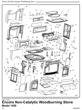

Possibly link a diagram of your stove and how the damper is attached.
My Encore's damper has round pivots cast into it. The damper is retained by small pieces of steel that are attached by a bolt on either side. The lever on the side of the stove actuates a rod that pushes the damper and has a metal strap it's retained by on the back of the damper. The easy way on my stove is to remove the pipe adapter and it gives total access to all of the mechanism. I have removed mine from the front but my metal tab on the right side was bent from years of use and I was able to slide the damper far enough to the right to get the left pivot to clear. Getting the actuator rod in the back hooked up was a trick, one time I had to take the interior cover on the left side off to do it.
Here's the parts diagram for the Encore 1450. It's a non-cat stove. Looks like the damper bolts or is attached to a separate damper rod. The damper rod must be true and not warped or it too should be replaced. Does place where the damper seats have two retaining clips or guides for the pivot rod ends?
So no instructions/manual I was asking for then?
A parts diagram doesn’t tell me how to properly replace the damper

#12 in the pic is the steel tabs held by a bolt and they hold the damper in place. Pic is a little odd with #13 looking like it's retained by those tabs. Mine has the ends of the cast damper going under the tabs and the damper in the pic looks like mine. Remove #1 and it's all right there.
