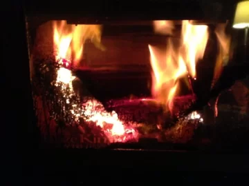

Last night @ 9:46pm (creosoted up front door was from me trying to burn green wood on previous wood fire attempt and dampening it down because I got the new stove and couldn't help it.)

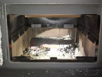

7:40am (no smell outside, I checked) and still giving off heat, 71F in stove room, was coming close to dropping out of active zone so adjust the bimetal thermostat to give it more air:
