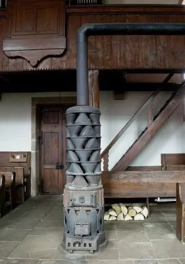

Be a pain to clean but if you circulated air through it would you get more heat ?
It isn't practical in any way but thought I would start a discussion on it ......
Looks like someone had dozens of oval to round transition pieces left over and put them to use.

interesting in a "steampunk" sort of way. hate the install, but that's not necessarily the stove's fault.
I wonder how much heat is scrubbed out of the exhaust stream (what im really wondering is how much crap is built up in that long horizontal pipe up top.)

I believe hazard unless you pressure wash it and only use good dry hardwood ....
I suspect its functional to a point, adding surface area in the exhaust stream is an old idea as is "thermal mass" look up "Russian fireplaces" they had some interesting methods to store heat and radiate well after the fire has died out.

Yes but I must emphasize on hazard because of the build up that would result in the design ...like stoveguy2esw said .... " by the time the gasses reach the main pipe there isn't any heat to burn off the creosote .."
Fire hazard I believe....

yeah, you're right note this isn't a reburn stove, so its wasting a lot of heat up the flue as well as a bunch of unburned fuel. the long horizontal allows for a lot of collection of this fuel and with the "heat sink" the guy built into the top of the stove the stack gasses will cool faster than normal, making a fue fire a distinct possibility should the stove be left open long enough to raise the stack temps to a point where ignition could happen. looking back at the picture its hard to see if the pipe has been compromised due to the lighting I think.
that said I think the look is kinda kool, but i'd be much happier with a straight up through the roof install with an insulated pipe rather than a up and over they have installed. be a shame to lose all that old woodwork , and more a shame to lose the church to fire in any sense

This stove obviously isn't original to the church .... It's art and if
It's even functional is questionable.
An artist that isn't as old as the church built this but it doesn't say if it is actually in working order or just standing art . I'm assuming standing art because the work involved to keep this thing clean would be substantial.
Burn pine in your stove and see what happens ,I'm quite sure it will have the same results as burning seasoned hard wood in this stove ...... FIRE ......
