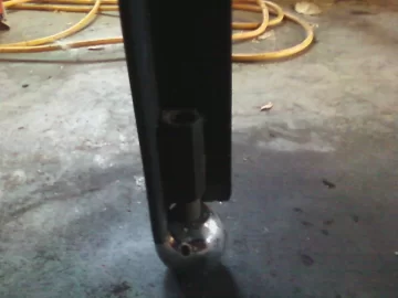

The last pic is of the leg leveler, the chrome ball slips over the stud and a set screw secures it. Do the other chrome feet or old handles have set screws?

Yes, the ball feet have a set screw to tighten against the threaded rod.
