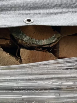

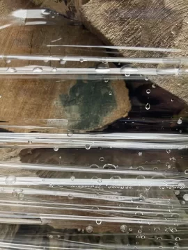

We are having a very unusual summer here. Much wetter and not as sunny. My wood kiln isnt looking good. Im getting mold on the ends of some pieces.
We are usually sunny and 90s.
Should I leave it or go natural?

Top-covered is good, but the plastic wrap on the sides is blocking ventilation through the stack.
Yes, without the sun it is having the opposite effect.

If it were me I'd leave it alone
Just make sure that there is good ventilation underneath
Sunny hot weather will return and it will kill any mold
