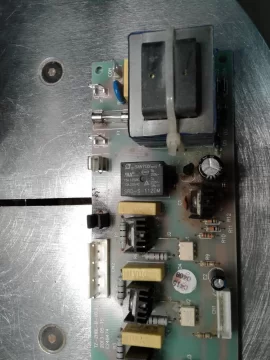

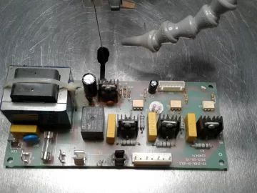

From my post from yesterday auger motor runs. attached cord to motor.
6.6 ohm on exoust motor, it runs attached cord to motor.
No continuity on vaccuum switch
47 ohm on igniter, was getting a reading of 4.8 vac from board to igniter?
.004 ohm on blower motor,attached cord and ran.
Basically wondering what might have happened to board to cause the melt down,stove was running and dry.
Also is their a better place to get new board? I FOUND ONE FOR 271.00 OUCH!,,

Possible bad solder joint at the fuse terminal. Possible it was spread and not making connection well o the fuse.

My main question, was ,any one know if board blew do to motor or something else grounded,any way to check before installing new board?

View attachment 290197 View attachment 290198
So I had this happen on my 25pdvc and from the looks of it the bottom auger motor shorted which blew the fuse but it seems when the fuse blew somehow it still was making a connection on both ends of the fuse.
