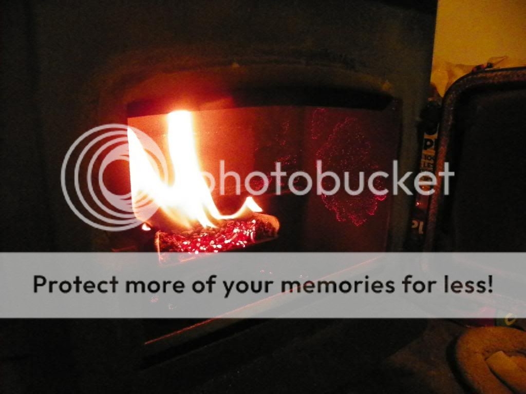

Just saying, lazy flame while running usually means bad seal. Warped ash bins are common on the PP38 since the door and bin are one and the same. Just tossing it out there. Does that top of the bin look arched left to right when you look down on it?

Here is a pic of the inside of my box...See the soot burning on the sides..

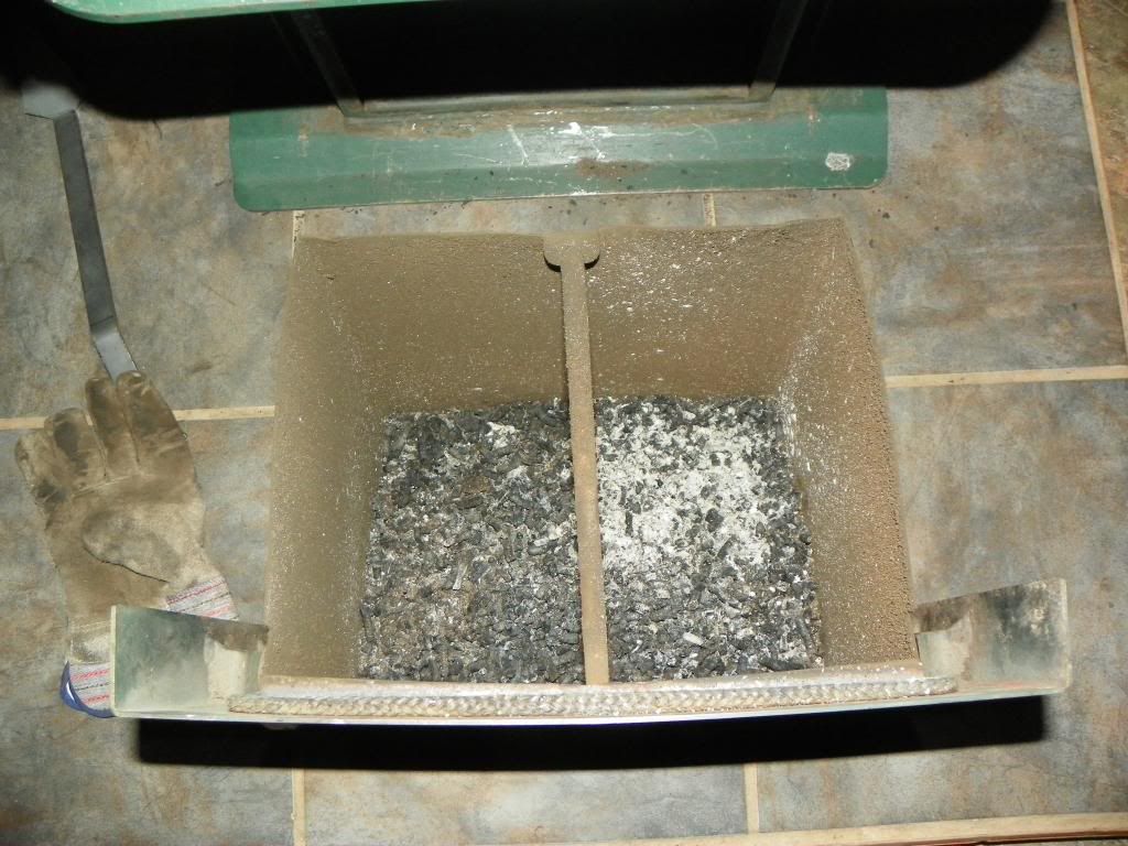

View of ashpan for my p38...Does the front edge look warped? The pellets inside are from burning for a few hours on #1 on the feed dial...Something just isnt right on it and I dont feel safe burning it at all.

Looks to me the door-ash bin is bowed!? Optical abnomally? When was the last time the main door gasket replaced?That stove is a 97 and you will have to expect some wear and use issues. None look to hard or expensive to fix.
Door gasket replaced about 5 years ago when I bought stove...Never changed ash pan gasket...do I need to replace the entire ash bin or just the ash bin gasket? Thanks for the replies.
joe
It does look bowed, but the lines in the tile don't look bowed, so I don't think it's a camera thing. That flame is fat and lazy, not enough airflow. You could try the dollar bill test around the ash bin when it's installed.
You might be able to straighten out that bow, and I don't think any amount of gasketing will help until you do.
I see the bow in it..we could see it right away...I am thinking I need to replace the entire ash bin and the main door gasket.
Did the dollar test on the door...the paper will not pull out at all on the left side or top but towards the right side you can pull it out with some resistance.
If the front of the stove where the pan mates up to the stove is flat and the pan is warped you may be able have a shop with a press gently bring it back straight. Not really hard to do. Then replace the gasket on it and on the main door while your at it as I noticed it may have an issue as well. IMO. If it were me I would block up the edges of the door and put a wood block on the bin front and give a love tap with a 8lb sledge to get it straight.
