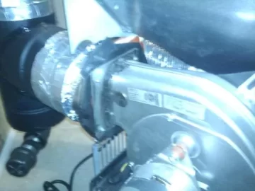

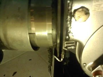

Here you go Vinny,
  • [Hearth.com] Update Of where I stand.
yeah, it definitely looks like that gasket is not tight enough. i had the same issue and ended up creating a thicker gasket by using two gaskets bonded with high heat silicone. i also bent the tabs that hold the starter tube a little bit closer. this was a pain to do. it is a major project.
i am also wondering about the stove adapter on the starter tube. I don't see any screws or any evidence of silicone. You need both. Also, there seems to be a gap in the adapter tube - if so, that would give off major smoke. I don't like that adapter at all. What brand is it?
The starter tube, has heavy silicone, its just black so very blended in. As far as the stove adapter, it was leaking, dealer filled it with rope gasket, and I filled it in on top of that with high heat RTV silionce. The model pipe I am using is Selkirk. I talked to Regency and explained to them that the gasket is not getting a tight seal. They said they would contact the dealer, and find out what has been done, and what is going on. He said the same story I have been hearing, you are the only one in the north east that has had any problem with this stove, but we know this is BS, Vinny you have even had issues. I also contacted Icc, and found out a local chimmney sweep carries ICC Excel pipe and they quoted me 550.00. I eventually want to change the pipe, but that is not the problem it is sealed and working great. I may have to do like you did, and double the gasket and bend the lip in a little. Oh sorry vinny that pic on the right was before the stove adapter was sealed. My fault for not explaining. Also no screws needed, it has a band that is tightned down, with the sealent, and that thiing is not coming off trust me lol.
sounds like a nightmare because people don't take responsibility to know their product and support it. as far as filling the adapter with rope gasket that just doesn't make a good seal that will last.
personally, i would not want just a metal band holding the adapter to the stove - a couple of screws would make to sleep better at night. however that is not your problem currently.
keep hounding the dealer, Regency and even the distributor.
that piece with the folder metal tab is part of the exhaust motor housing which can be unscrewed and swapped out. maybe if they gave you a new one the metal tab will be better folded on that one. if you/they do that, remember to get a replacement gasket for that too.
good luck.
Broken- Understand your frustration completely, that connection is not the easiest. I have found on a couple of M55 stoves that we needed to put screws through the other corners to draw it up tight, because the lower lip that the conn flange sits in gets distorted and doesn't want to fit properly, espec after its been removed a couple of times. I've talked to Enviro about this, their answer is that they don't expect that flange to be taken off every year when the pipe is cleaned ??? Anyway, you can remove the comb blower and clean backwards, (not break the connection) or do the extra gasket thing or put bolts at the corners. I know its extra steps and you shouldn't have to, but its just another field fix we service guys have to do. I know that does not help your frustration level, just as us telling you thats its a good stove prob won't help. I'm still big Enviro fan, all in all good pellet stoves and great wood stoves. Keep poking, someone will listen and get it right for you.

Thanks for the replies, The regency rep said they would call me back in the next day or two so that is where I stand. Its funny to hear these stories, but everytime I am told that I am the only one in the world with suchs a complaint. Stovelark I agree the stove is on now its a workhorse, I just wish they would take credit for some poor engineering when it comes to that bolt up system.
good luck.
vinny here is a quote from slekirk installastion instructions about the multi fuel adapter,
The Adjustable Pipe Connector (APC) and Multi-Function Connector (MFC)
have an adjustable hose clamp on the inlet end to connect to the flue collar
without the use of supplemental screws.
