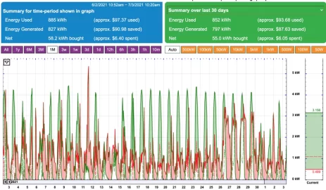

Yes, we have an eGuage system monitoring the solar output and whole house usage.

I have been monitoring the system on sunny days. What I now think I am seeing is that each of the two channels is clipping at around 2130 w. This would be to stay within the 4200w design capacity of the inverter, though I have seen it peak at 4500w occasionally. If this is the case, and the SE panels could actually be trying to put out more wattage, then theoretically I should have about an extra 1.9 kW of output potential between the two arrays. (Say 2600w from the SE array and ~2500 from the Itek array) This has me wondering about the least expensive option to achieve maximum output from the existing 2 arrays.
What is the nameplate rating and number of panels on each string?. Do you have single or multiple MPPT circuits.? IMHO, I always underload inverters instead of the industry tradition of overloading them and clipping them on the "good days" I think my approach puts a bit less stress on the electronics.
That's easy to test. If this is the correct manual for your inverter, and the correct specs for you panels, the inverter can have up to 3000 watts per MPPT channel to a maximum of 16 amps DC. By math both your SE and Itek panel strings have voltages over 300V at Vmp, so the 16 amp spec isn't the limiting factor, the max 3000 watts per channel is. The other interesting thing is that your inverter should actually be capable of 4600 watts output total if it is connected to 240 volt AC and not experiencing thermal derating (happens above 40c).
Simply unplug or disconnect one array at a time and then monitor the output of the other, this will reveal what each array is capable of and will determine if the inverter is experiencing significant clipping, or if it is the panels limiting output.
