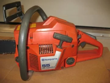

Where'd you see that? I'm not far from GF...I didn't see a rancher on Craigslist.
(broken link removed to https://albany.craigslist.org/tls/5018851940.html)
Needs a bit of work, or I'd be telling you to get it for yourself. I think it might be a closed-port model, which is the more desirable version.
I saw that one last night on Albany Craig's List. He is selling because he thinks it might have carburetor problems. Like you according to him it will run for a while then stop. I am having the same problem and was looking when I saw this. Might be a good deal if it just has bad fuel and/or carb simply needs adjustment/replacement.
The 55 has an Achilles' heel, some plastic and rubber parts that sit between the cylinder and carburetor which are degraded over time by heat from the motor, causing air leaks. You can probably get the replacement parts for about $20, and the repair isn't terribly difficult. Very common problem with an otherwise reliable model.
Is model 55 normally closed port, whereas, 55 Rancher is more likely open port?
505 31 0751 is the impulse grommet - a SNEAKY air leak that can trash the top end.
