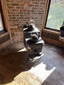

Got a pretty nice baby bear in our main living room. The original owners of the home bills in addition and had a chimney built to accommodate the Fisher. when we bought the house two years ago, we opened up the space. It's a large room with vaulted ceilings and no attic. They had some baseboard heaters plugged up to extension cords but we took them out. The baby bear is the only source of heat in this room, and while it does a decent job, it is so in efficient. It typically heats the top level of our home at least three degrees. I'd really like to replace it though so that I don't have to split and house an entire forest of wood for every single winter. We installed a newer much more efficient small stove in the basement with a blower and liner and have been happy with the results.
Do I have any options that would not involve cutting into the existing chimney? As a woman who cares about the looks of the living room, I'm not thrilled about the idea of having a huge hole with just a plate showing. hubby just had the Fisher sandblasted and is in the process of restoring it. Right now I just see this ugly hole and hate to drag it back in here lol.

Why would you need a huge hole?

I guess I assumed I'd have to come up higher in the chimney to accommodate a stove with the pipe on top and this existing hole would be deemed unusable since it's specked specifically for the baby bear?
Ok so you either brick it closed or turn it into a clean out

Many newer stoves have a convertible outlet that flips for top or rear vent. Measure the height of what you have, and compare to the height of the newer stove you choose in the horizontal position. The horizontal pipe must rise at least 1/4 inch per foot toward chimney. More is fine if the new stove is lower.

Great. This is the info I wanted to have/know. I just assumed there weren't any options. It seems awfully low. 1/4 inch per foot of the stove you mean? I wonder if I can just choose something that falls into these specs.
If I decide to cut into the chimney I assume we just use a wet saw and we'll need to get a liner since the existing is just a clay tile liner. There is no bricking up that hole though. It would never match and would look worse than a plate over the hole.

No need for a wet saw. I would just use an impact hammer. Or our arbortech.
And of course the hole can be bricked shut to match we do it all the time. You take the brick out from above and use them to weave in the bottom. Match the mortar and it will disappear. You also many very well need an insulated thimble unless that is solid masonry all the way through.

You do have a thimble it's just a question of whether there is enough masonry around it. Can we see a pic from outside?

My brain is just not comprehending lol. My house is brick. I can snap a picture, but there is nothing different about the outside. This is an addition that was added onto the side of the house. There isn't even an attic portion. There definitely isn't any sheetrock at ALL in the room. They used T11 siding inside (or something similar). I'm sorry I'm all sorts of confused.

Ok but is you house brick faced with framed walls inside that? Or is it brick structure? Are you sure there isn't a framed wall between the interior and exterior brick?

I see what you're saying now. How would I tell? I went outside. It's in the corner so I guess I don't know what they used to form that triangle.

The only way to really know is drill test holes through the mortar to find out what's behind there.
