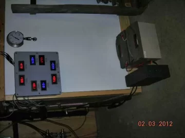

My overheat circulator is controlled by an aquastat that I mounted in the spare well tapping on the top of my eko. When tripped, it circulates boiler water through a coil in placed in the bottom six inches of my 500 gallon upright stainless unpressurized tank.
Although the plan is to be able to run the entire system with the inverter, however I only have the back-up power hooked to the overheat circulator.
Since I only have one, three to four hour fire per day just to recharge my storage I don't feel that it needs to be hooked up to run the entire system. But I have the capability if needed. Just need to unplug a couple cords (electric kind) from one receptacle and plug them into the inverter.

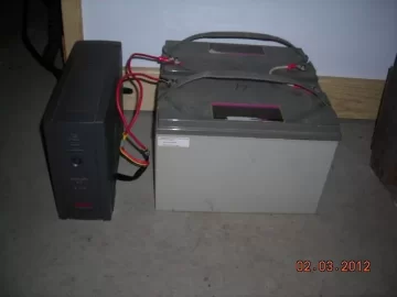

My batteries are 2 x 12vdc at 104ah each, deep cycle gel cell type. With just the Tarm draft fan and controller plus the 15-58 on HI, draw is 200va, which is 200 / 24 = 8.33 amps. For longest battery life the recommendation is to not draw down the batteries below 50%. That means that operating time is 104 / 8.33 / 2 = 6.24 hours. In an emergency the batteries could be drawn down to cutoff and I would estimate another 3 or more hours, perhaps. With the entire system active, that is adding the 007 and 009, draw is 400va, so operating time would be 1/2, or 3.12 hours to 50% draw down.This should be plenty of time to cover an emergency power outage if I was not around to fire up the generator.
A lengthy power outage of multiple days would require more, and then I would use the backup generator. I have a 2000 watt pure sine wave inverter generator which is sufficient to power the entire system and recharge the batteries.
