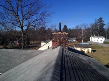

So do you have a 90 degree before entering the new chimney? What was the old chimney, 8" clay tile, now a 6" liner? And I think FF Jake's suggestion is a good one. You could add a few feet of cheap dryer vent as a test first, but w/o looking at the manual 15' sounds close.
Pics often help BTW, inside and out. Other structures like a second story roof or obstructions like nearby trees make a difference.
Jatoxico, the old chimney was an 8" clay and now has the 6" liner. i have a 45 then the liner starts. I added 2ft of pipe this afternoon and waited for a little wth no benefit. Smoke is still escaping when door is opened.

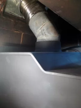

I don't know this stove and the docs are a little weak, but here are some generic tips. Check the baffle. Make sure it is properly in place. Is there a blanket on top of the baffle? If so, check and make sure it laying perfectly flat and not bunched up. If the chimney has been cleaned make sure there is no pipe of sote blocking the flue collar.
Is that a galvanized adjustible elbow? If so I would replace it with stove pipe. It also looks like both sides of the elbows are awfully deep in the collar and liner. I would replace with a black pipe elbow and put a few screws to anchor the elbow to the stove. From the looks of it, there may be some leakage at the stove connection. I've never seen an elbow so deep apast it's crimps on a stove.
Good observation. If the elbow is too deep it may be protruding into the smoke path above the baffle. It shouldn't be deeper than the flue collar.
Good points above about mechanical blockages. Does not look like you ovalized to get the liner through but if you did that can be the cause of pinch point. One other question does the situation improve at all when the system has been run for several hours (ie fully hot) or same, hot and cold? Any better when it's cold outside, like it's getting this a' way?
If there is no improvement when the chimney is hot it may point towards a block like mentioned above. If yes it may take a bit more pipe. You would not be the first member who saw a difference with 4' of pipe added but no (or little) difference with just 2'.
It also appears that the connection from elbow to flex liner is backwards, the liner should be going into the elbow to allow and liquid creosote to drip back into the stove and burn off.
Reactions: Owen1508
wow, thank you all for your input. Makes me realize i still have soooo much to learn. Jatoxico, the situation doesnt improve even when stove has been running for hours. Begreen and laynes69, the elbow is quite deep. Im very curious as to why that would matter, but will def replace that elbow. And kennyp69, your suggestion makes a lot of sence, i will change that as well when i replace the elbow. Thanks again everyone for your time, i will be changing some things around on my days off and let everyone know if it worked. Have a great weekend, seth
The elbow should only sit in the flue collar an inch or so. If the end of the elbow is protruding into the stove it could be blocking smoke flow. That will lead to smoke spillage when the door is opened and poor burning.
Well if it don't get better after warming up that could speak to an obstruction. I think what layne69 is suggesting is that if you push a section of pipe too deep into the elbow it begins to close the opening by covering the hole from the inside curve in the elbow.

You might be better off with a liner connector at the end of the flex pipe so you can connect it to your elbow correctly
sounds like the House Stack Effect to me. Is your chimney top shorter than any other point of the home? If so then the "draft" inside the home is greater than that going out of the stove, causing your blow back problems.
Nice get, my money is on this being the problem.
Yeah, there should be some tabs inside the flue collar to stop the elbow from going in too far. That elbow is probably getting past the tabs.
Agreed, you need the elbow that is made to fit that liner by the mfgr. of the liner. I prefer the one-piece welded-seam stainless elbow, but there may be cheaper ones made by the company. The one with the crimped end should fit right into the collar and hit the tabs. Hurry up and get that thing on there; We're anxious to hear you rave about how great your stove is running. >>
