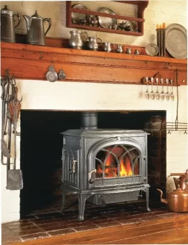

Here is a beauty shot of the F500 in iron enamel.

So the iron color finish is an enamel finish? I guess I didn't think its enamel.
I've only seen it in enamel, but perhaps there is a paint version too? Is there a low gloss to the finish or is it flat?
Well its not like a flat black but it does not seem like a super gloss like the porcelain finishes. its like an eggshell or satin
Well, I remember Jotul Iron but it was for mainly the gas stoves. I do believe BG may be right, for the wood side, it could be enamel. It wasn't a common enamel color. Is the door handle chromed?? If so, that is enamel iron.
That sounds like enamel, but without the porcelain glaze. This is the same as my avatar's blue black enamel. It's a handsome and durable finish.
If memory serves, Iron enamel was a porcelainized finish (glossy). Blue black is the only "satin" finish that I know of, attained by not baking in 9 layers of paint to a porcelain finish, but instead 6 or 7 coats. That is also why blue black is the least expensive enamel finish. I do know its my favorite enamel color. Hearthstone makes a blue black satin finish also, its a dark blue-gray. Its very appealing as well.
I think the ivory is/was also available in non-majolica enamel, at least it was a few years ago, but not sure about the iron. That's a rare finish. If it's low gloss then I suspect it is also not majolica glazed. Searching on the interwebs I find some shops still listing iron enamel.
(broken link removed to https://bollenshearthshop.com/shop/jotul-f-600-firelight-cb/)
There is a stove bright iron paint available. They call it Jotul Iron....It is also a flat version, and is very very sexy. One of my faves. I like being able to re-paint. Enamel is pretty but can be finnicky
How so? I found the blue-black enamel to be almost bullet proof. Our 1980 Jotul 602's cranberry red majolica finish is still in very good condition too.

Agreed, the Blue Black available from Jotul has been the toughest enamel I've ever seen hands down. This includes Quadrafire, Enviro, Vermont Castings, other Jotul enamels and the list goes on and on. Jotul Blue Black is also beautiful. Some of them you look at them and they chip. I put new andirons, a brick retainer and a new brick set in a Quad Isle Royal the other day. It was the sahara color. It was missing enamel EVERYWHERE. It was also in spots that didn't really see typical abuse.
No the door handle is the same color and finish as the stove with a wooden knob.
