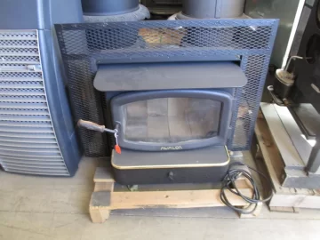

Just started researching here and though I would try and get some info from you here. I was ready to pull the trigger on a Heatilator eco insert $1200, then I found a used Lopi at a fireplace store for $950 he says it works great has blower 1998-2000 model, the fire box is around 1.8'. My house is about 1100sf on the main level which is what I'm trying to heat with this unit alone, will this get the job done? 50,000-60,000 BTU?

Picture didn't come through. It sounds like an Endeavor which is a good stove. $950 seems high for a 13 yr old stove. Ask if there was work done on it like burn tube and firebrick replacement. If not, offer $800 cash and have it on hand.
Can you see if this picture works? If not I could email you the pic? I can't seem to find this model online? He said he replaced some of the bricks and cleaned the blower.

That works. It's an early Avalon, not Lopi, it lacks the bypass. I thought maybe an Olympic but the firebox looks too small? Maybe a Pendleton? There should be a tag on the side or back of the insert that indicates make/model Or measure the firebox up H + W + D to figure its cu ftg.
EDIT: I'm thinking a Pendleton. If so, this is a small stove, 1.3 cu ft. It will not do an overnight burn well at all.
