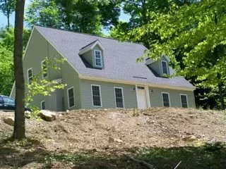

The house is a slab on grade, 2,000 sq ft, two story new england cape with pre cast concrete walls, ("superior walls LLC" to be exact.) R-19 insulation in the walls, R-30 in the attic. The stove is located in the LR. The yet to be installed air handler will be placed in a second floor bedroom/office located directly above the fireplace/wood stove, shown on the attached plans.
Basically i'm just trying to get an even distribution of heat throughout the house more specifically the first floor, as the second floor bedrooms have baseboard heat. The master bedroom is always very cold. Also the dimensions of the house were expanded to 36x36.

Madison brings up a good point. Is this an old picture? I don't see a flue pipe on the house for the Dutchwest.

The picture of the house is an older one, I didn't have the chase complete at that point. The floor plan isn't exact, very similar though I'll try to find a jpeg of my actual floor plan. BTW thanks to everyone for your time and advice for a noob like me!

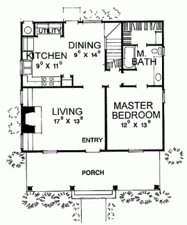

Here is a much better representation of my floor plan. Keep in mind the actual building size is 36x36. You would think w/ the location of the entrance to the master bedroom would make it easier to heat. But I tell you it was so cold back there, my wife and I slept on our mattress out in the living room.

That makes a big difference. With this layout, I can pretty well guarantee that a simple fan, set to low speed and placed on the floor, blowing the cold air out of the bedroom and into the LR will make a very nice difference. Trust me, I have tried it and it works. Warm air will come in to replace the cold air. Try it next winter. If you like the result, but don't like the fan on the floor, then I would do the vent in the wall deal as previously described.
The F600 and a couple of strategically placed fans will easily heat that floorplan, so long as all the inside doors are left open to allow for the colder air to be "pushed" toward the living room; you should have no problem keeping a pretty level heat throughout the floor. The woodstove room will always be a bit hotter, no getting around that.

Oh ho ho . . . this new floor plan changes things. Like BG and FWWarden I think I can safely say adding a fan on the floor of the hallway near the masterbedroom with the fan on the low setting and pointing towards the stove should make a difference in how warm the bedroom is this winter. As BG mentioned this is a simple and easy thing to try . . . if it works you can tell us later how smart we are . . . and if it doesn't you can feel free to berate us ;) or try cutting some vent holes in the walls or hook up to your heating system.
I suspect this will work though since many of us are able to heat our entire homes in this way . . . myself included . . . and incidentally I was wrong . . . I believe I may be heating my home (1970s vintage with 2 x 4 walls, insulated with fiberglass insulation . . . about 1,200 square feet on the ground floor) with an Oslo . . . which is as you may know the smaller brother to the Firelight.

As to why the fan trick will work . . . yeah, it sounds ridiculously simple . . . and it is . . . but it works because you're taking a stove that primary heats an area through radiational heating (think of the heat as coming out from the stove in straight, direct lines and hitting objects in the room and heating them up) and introducing a convectional way of heating (i.e. using the fan to set up an artificial wind current) which will take the heat "trapped" in the room and slowly circulate it to other areas of the house.
