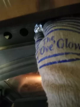

With the louvers off try wedging a piece of aluminum foil in the screw hole and the lower right and left corners of the louver slot. I had a crack were the two pieces of sheet metal meet in lower right corner that whistled. I now have orange rv silicone in the crack. To find were the whistle was coming from I made a golf ball size of foil and moved it around louver area blocking the flow. As stated mine was lower right of louver area were sheet metal meet and a little from the screw holes holding the louvers on.
