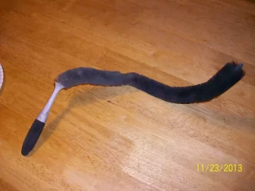

To many possibilities, to start: Clean clean clean, do the deepest clean you can, to include space behind the facial board I use a dryer brush

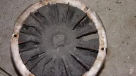

Clean fins on exhaust blower, clean fins in squirrel cage room blower.

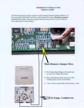

Do you have a external thermostat attached to the control board?
When you increase the heat range on the stove IE from 1 to 2 does the dash between the Hr-2 stop blinking? Should blink for around 10 minutes while stove ramps up then go solid red.
If no external thermostat check that the thermostat jumper is still in place, if you do have external thermostat you might want to unhook it and replace the jumper to see if external thermostat is working right. If attached to a non working thermostat or the jumper is missing stove will run on idle no mater what heat setting you are asking/set for.
