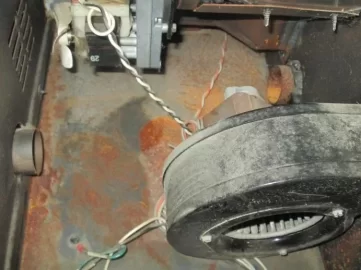

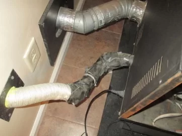

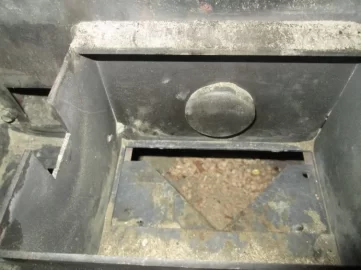

This stove came with the house. I'm currently taking it apart cleaning it out and trying to figure out how it works. It has an outside air intake, but I'm not sure it's hooked up correctly. It seems to just dump cold air right next to the room fan. It looks like there should be a second flex hose running from the outer stove wall to the fire box, but the tube to the fire box is capped off. Does any know if that is how it's supposed to be? I would rather crack a window in a spare room or something rather than dump cold outside air right to the room fan...
I'm thinking of adding a butterfly valve type damper between the house wall and the stove, adding a second flex hose between the outer stove wall and firebox, and removing that cap.

I do not know anything about your stove but I found the installation manual for the fresh air kit..(broken link removed)
Thanks for the link. I figured that's how it should go, but with the fresh air port right between the manual damper and burn basket it seems like you would loose your damper control...
Bob you are correct. There needs to be an addtional hose run from the outer wall to the "capped" tube behind the firebox. You can either remove the cap totally, or some have just drilled sme holes in the cap and left it on. To limit the flow of air. you will want the unit to pull all it's combustion air from under the burnpot, or as much as possible. I have seen some put a valve on the OAK to control the air as well, the speed of you combustion blower will also dictate the amount of air it will draw through the OAK. Once you get the general idea of the stove let me know and I will help you get to know the controls and adjustments better for that unit.
