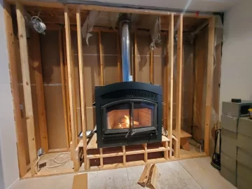

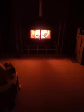

After waiting several months we got our Valcourt Waterloo Arched zero clearance installed. Did a few break in fires. I have it central in a 2200 sq ft single story home. Needless to say, this is the first time I've struggled to keep a fireplace from burning too hot! First full fire our house was 79 degrees and it was 15 degrees and windy outside. I didn't sleep well lol. I have no need to run my natural gas forced air heat in the last three days since we got it. We'll see how it does in -20 but so far it's outstanding! Looking forward to getting the hearth finished which I'll be doing over the winter. I hadn't considered the blower kit but I am now debating it before I close up the wall. It could be tied into my forced air system, or I'll run it to my garage. Either way I forsee the need to offload some BTU's to another location given it's output.

That's a big boy. If the far corners of the house are all heating well, then it makes sense to warm up the garage. It'll make those -20º morning starts a lot easier.

Nice! Fire pics, and heat in AK.

The other rooms are doing well. It's 6 degrees tonight and 76 in here. Haven't run the forced air since the install. The garage does have in floor radiant which I have set to 50. This is our first winter in the house. I'm actually quite surprised the garage temp hasnt dropped below 54 this far. I can attribute that only to the fact the utilities are in the garage. Hot water boiler, heater etc. There must be enough passive heat to maintain. House is also insulated extremely well including the garage. It's a fairly large (4 car) attached garage so I am impressed It hasn't dropped below 50° . I may see if I can get the blower kit and at least install the duct hose before I button the wall up. I have a great crawl space that I can almost stand up in. Basements are not common in Alaska. The only issue with running it to the garage is it will be right on the cusp of the maximum 50 ft, as well as the fact I would have to get through block to do it. I could run it through the ceiling but I think it would lose a lot of heat up there as it's not a true attic, and near the temp of the outside air.
