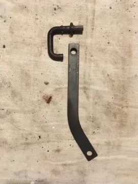

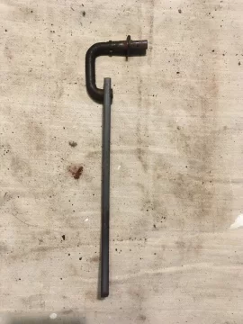

possible the damper actuator and rod detached.
Thank you -- that's what my husband said as well -- any easy way to fix it rather than open up the inside? I'm hoping he won't have to rip the stove apart to fix since he's currently busy renovating an entire house. He presumed exactly that b/c he said when he was rebuilding it he said it looked so easy to come undone. Murphy's law!
not sure if that is a c-clip seen in the picture. you'll probably have to remove the damper, working through the griddle or flue collar. flashlight and flash camera are helpful.

Start by removing the cover plate on the left interior side. This will reveal the two items shown in the pic.s, damper rod and "hockey stick.". You' likely be able to see what went wrong. If the hockey stick has fallen down between the inner and outer sides, don't waste time fishing it out, just get another one.
