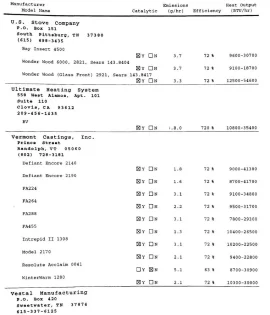

The attached image lists Vermont Castings products that were certified to meet the 1992 Phase II EPA limits.

Interesting. So this proves the fact that the 2461's were not released back then. The model #'s for the Dutchwests back then started with FA.

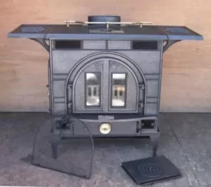

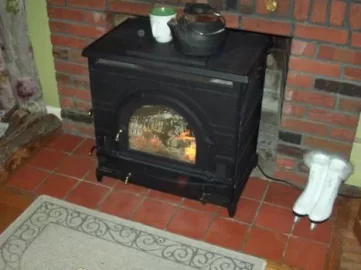

According to my previous research it was 1993 when they came out. This is an identification guide for Dutchwest stoves:
(broken link removed to http://www.discountstove.com/cdwidguide.html)
All the pre 1990 FA models had two separate screened air outlets on each side under the outer top as well as double front doors. 1990-1993 model still had a double front door and small glass but the convection air outlet was one big slot under the outer top with a brass bar across the slot. These model still had an air inlet on the ashpan door. After 1993, the ashpan had no air intake and the front door had become one with a bigger arched glass door. This is when the 2461 was born.
So here are a couple of pics the first was a nicely redone FA 264CCL. The second is of my own Dutchwest 2461.

I am fairly certain this is my stove as they do not list the brand Consolidated Dutchwest but it's described as C.D. FA264CCL etc... I believe it is EPA phase I compliant and was approved for Oregon and Washington State.. As clean as it burns it would be phase II compliant as wel in my opinionl.. Not bad considering how many smoke dragons were being sold at the same time when I bought it.. I was attracted to the catalytic claim to use 1/3 less wood along with the convection and many other features.. It was a big deal back in 1988...
Ray
PS I can't get over how nice that CDW FA264CCL looks.. I think it saw very little use and would love to own that one but it's selling for double what I paid for this one brand new..
Hey Ray, I knew you'd be drooling at that picture of the beautifully redone FA264CCL! :lol: It sure is a nice looking stove with all the bells and whistles! I'm going to attempt to put together a summary of some of the more common Dutchwest catalytic stoves from most recent to 1984, here it goes:
