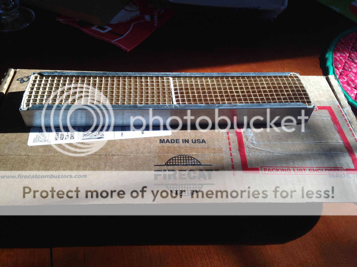

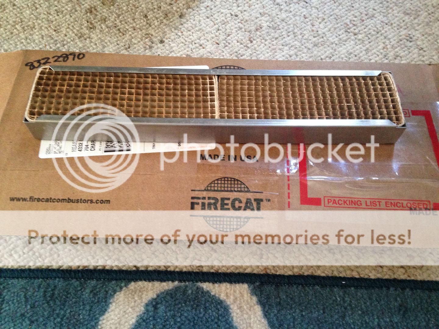

Slightly different..there were some little metal tabs on my original catalyst on the border (I never really knew what they were for), and the new one didn't come with those tabs. Seemed like there was a slight change in the way the overall metal border surrounded the catalyst material by like a few mm. Otherwise seemed almost 100% similar. I can't see these minor changes being a big factor in how it performs but i don't know.

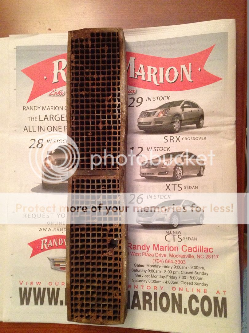

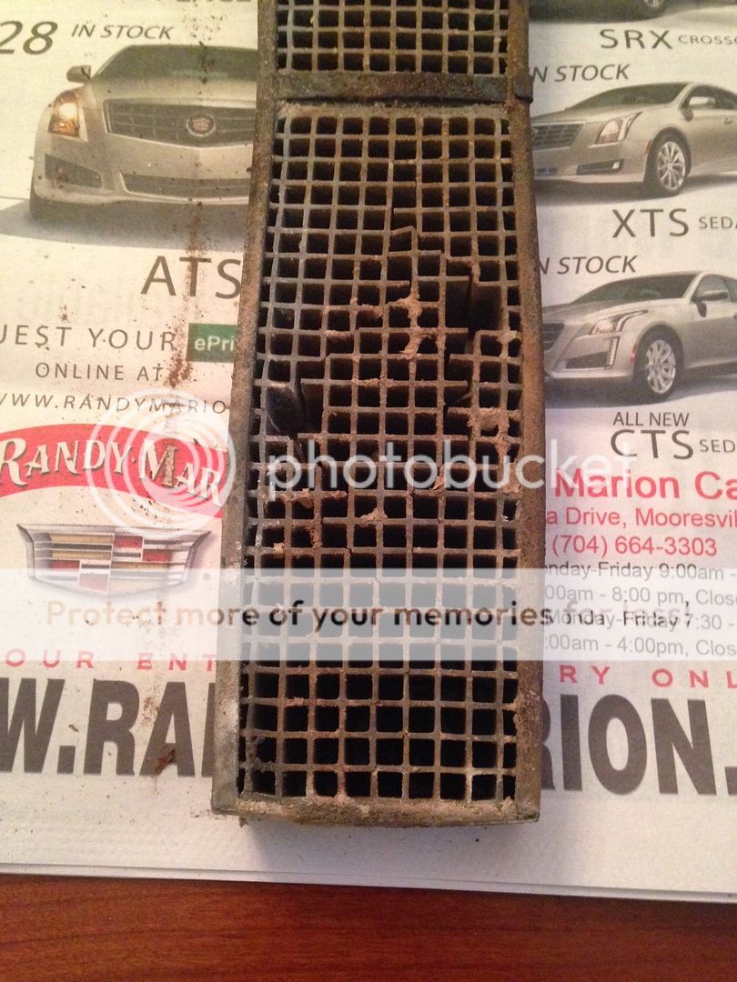

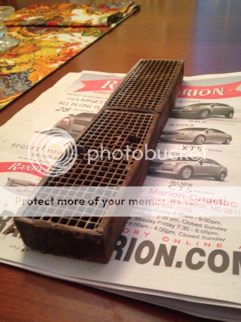

Here's the problem with mine.
[Hearth.com] VC Encore 2040 catalyst under warranty?
yep mine did the same thing. was still working but the longer it went the more cracked it got, and more and more little bits started to drop out.
So, this cat was in use two seasons? It does not look overfired.

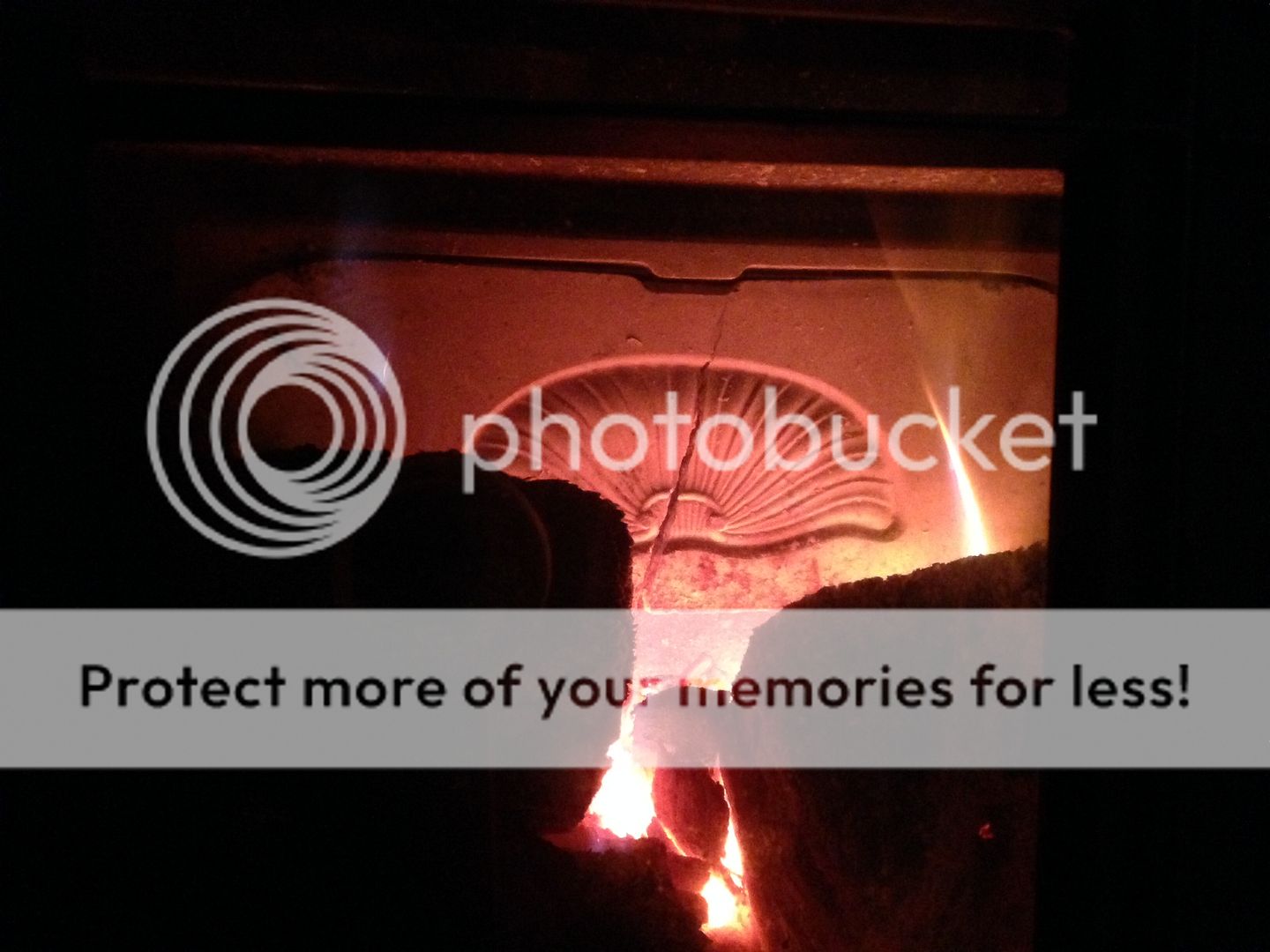

Another issue I had last year with this stove was that the refractory access cover cracked. Luckily it was under warranty & supposedly the replacement is made of a stronger material.
