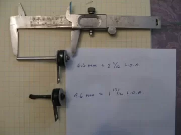

I'm sure you can figure out the gasketing, so I will tell you how to do a basic inspection of the secondary air system. The next time the stove is cold, clean it out as best you can and carefully pull the fireback and throat hood off by first lifting then removing the two wedges. Check the gasketing on the back of the fireback. There should be two short pieces horizontally near the top outer corners, and longer sections in an obvious channel vertically. These are absolutely vital for proper operation of your catalyst. I did not reallize I had a problem here until I really studied the back of the fireback, and the front of the cat chamber and thought hard about how air was supposed to move back there to get to the cat without getting mixed with the smoke too soon. Once I did that, I could see a couple of problems, like missing gaskets and a few other gaps that I jury-rigged for better performance.
Next, look at exterior of the combustion chamber "plug", which is the removable rectangular door covering the cat. If there are pieces missing, especially at the upper outer corners, some creative gasketing is in order.
Remove the plug carefully to inspect the cat and, as important, the secondary air probe. See photo attached. This probe conducts heat to a bimetallic coil which controls secondary air. This should be projecting about an inch into the space downstream from the combustor. When the probe burns away, the coil thinks the cat is colder than it really is, and it then provides too much air, making the mixture too lean, and tending to run the cat too hot. Alternatively, the linkage between the coil and the secondary air gate may come undone. When this happens, the secondary air gate is just always closed, starving the cat for air and running too rich (smokey). Remedying either of these secondary air problems requires gaining access to the back of the stove, which means pulling the insert and removing the cabinet, a 2 hour PITA start to finish.
"Blow-by" is a problem separate and distinct from a secondary air leak. Blow-by describes the problem of smoke getting past the combustor without going through the combustor. This can happen when the cat gets distorted and does not fit well in the chamber, or the chamber fails structurally and does not seal well. Creative gasketing helped me here also, though a new chamber is the right solution. Look for evidence of blow by while you are in the combustion chamber. My clues were a sooty trail on the outside of the cat, and some other smokey sooty clues to mismanaged flow in the chamber.
Finally, the combustion chamber should be vacuumed clean of fly ash so air can flow through unimpeded. This is a delicate job so dont just stick the vacuum in there. My advice is to make an extension for your vacuum cleaner using soft vinyl hose of say 1" inner diameter, and gently suction out the chambers. The alternative is to remove the combustion chamber, which I have done a few times, but just be aware that you are holding a part worth about $300.00 in your hands and it is more fragile than eggs. Proceed accordingly.

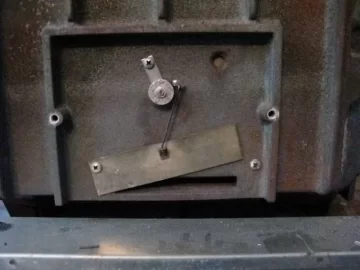

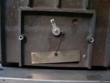

About secondary air, you might be interested to know that there is some adjustment possible by "clocking" or rotating the thermostat coil relative to the fixing arm on the secondary air control. The pictures tell the tale. Note that both pictures are taken with the stove cold, but the air door position is different. Accordingly, in one case the door will close at lower temps than in the other case. This is one possible way to adjust secondary air for your particular draft situation.

^^I'm not really sure what the purpose of that "extra" hole is seen in both of those photos, above and to the right of the secondary air thermostat, but it's an air leak so I plugged it with stove cement. Seems to me it could be used to mount a cat thermometer probe -- a hole drilled through this point would penetrate the cat.

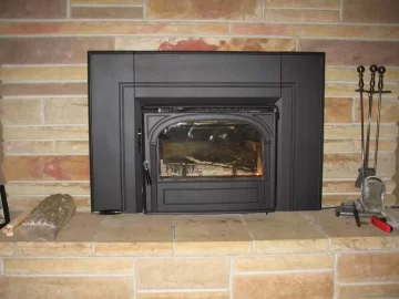

Yep, I think I'm getting to better grips with this stove. I have adjusted some of my methods, for ex. mixing sizes of splits so that they gas out at different rates and don't cause such spikes in the burn. On a bit of a tangent, I am a high-performance engine builder/tuner by trade so I understand fully what you are saying... parts are half the battle, tuning them is the other half. Anyway... thanks for the pics of the 2ndary air control. I haven't seen the little bugger with my own eyes, yesterday I didn't have to pull out the stove to install the blockoff so I didn't go there. The pics give me a few ideas about making a manual "backup" air control that could be run via a rod that you twist from the front. On my setup I could also install an outside air kit that would go thru the fireplace's ash dump and route to the cleanout door outside. It would be a pain to adjust that way, but at least I could find a choke setting for those "worst case" scenarios. (great draft, high winds) Or, I have an extra bottle of Argon here in the shop that I could just plumb into the air inlet. <lol>
The blockoff plate elevated my morning house temp by about 3 degrees, BTW.
Shoddy pic attached... doesn't tell much but there the little beastie is. ;)
