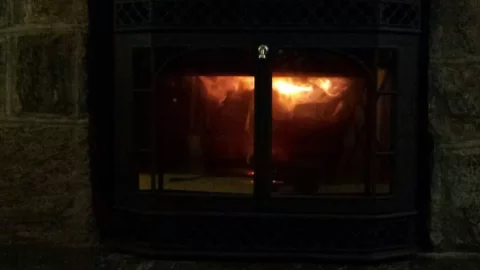

How does my fire look? Fan Finally kicked a few minutes ago but from what I read, the Merrimack always takes a while...

That is a beautiful stove. Fire looks nice.
I've got a tiny crappy old insert that I simply get as hot as I possibly can, often so loaded with coals that they spill out when I open the doors.
Getting to a hot fire for me is simply a progression of paper under twigs under sticks under lumber scraps I want to unload under softwood splits under hardwood splits until I get up to hardwood logs or knots that won't burn themselves, but last forever. So I toss splits in with them. If I neglect it for a few hours the coals will burn down.
I'm always shooting for 600 degrees on my stove face and have three thermometers on the stove face plus an IR thermometer (only goes up to ~610 F) for the glass. (broken image removed)
My setup looks like an ashy mess, but is always behind the fireplace screen to keep the kids away.
I'm trying to build up a load of coals to lay a big knot on it in hopes of getting heat through most of the night. I get the impression that this would overfire some stoves, but this one has a temperature controlled air intake and dampers itself down as it gets hotter. I'm constantly trying to keep it as wide open as possible. I can't get the first started with that. I need to leave the door open to run enough air through there while starting a fire.
If the wood doesn't burn, add smaller dryer splits, and give it more air.

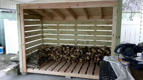

Wood shed is almost done... started sat morning and worked all day and a couple hours sun. He found some pland in the internet amd made a couple changes. Just gotta get some more plywood for the roof and some shingles... not too shabby! Time to order my cord!

Wood shed looks nice. Might want to get some larger splits for over night burns. Loading up with those small splits will certainly produce some very hot fires. The more surface area in a load produces all the BTUs a lot quicker (hotter stove temps) than less surface area on big splits.

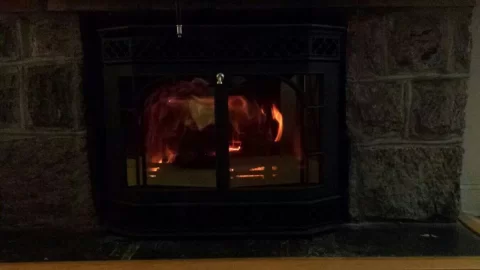

So i got a nice fire going last night but i am wondering how hot is too hot... my secondaries were going strong but when i hit them with the IR thermometer they were too hot to register. I could barely see flames on the logs.. Lower near the logs i was getting like 650 deg on the IR just on the top of the box.. is that normal? I was scared the thing was burning too hot. I was so nervous to reload before bed because i wanted to keep an eye on it.
Heres a pic..
Wow ok sounds good hopefully the delivery will have larger... all of that is stuff that was given to us and my boyfriend cut. I will get larger stuff!
I find it is best to have a variety of sizes of wood, I burn small to medium size to get the insert good and hot, then after the fan kicks in and heat starts pouring out, I use medium to big stuff and choke back on the air flow so it burns good and slow...then when 11pm rolls around I put in 3 or 4 big ones and let it burn all night. By the next morning, I still have embers enough to get it going again.
