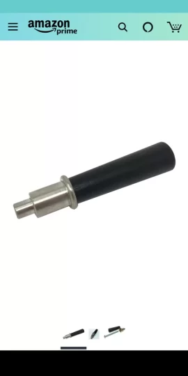

My handle is a loose fit with no threads. It's made to be put in each time you use it then removed . If that was the way yours was did you drill a hole in it and put a screw in it or did you buy one that will screw in?

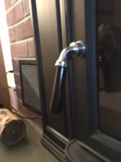

The handle on my stove attaches with a screw through the center of the dowel.
I did a quick look around on the web, and couldn't find where they came from the factory with a removable handle. Are you the original owner?

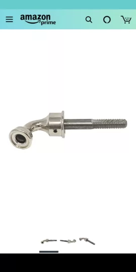

That looks like mine but mine has no threads. Yes I bought it new and the dealers said that's the way they are. I Googled it and found the threadless one for sale on Amazon
That metal piece on the handle comes off. Look down the wooden end of the handle, there is a screw inside. Unscrew that, and then screw it into the metal lever on the door.
Well I was at my cabin and you are right. The handle unscrews from the metal stub and then screws into the pivot handle on the door. Thank you. I only wish the dealer would have told me that when I asked him.
I still don't know where the secondary air inlet is located but at least I have my handle attached.
