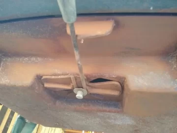

OK - the air intake is about 6.5" x 4.5"; and 1" deep. I have yet to clean the rust off the bottom - anyone have a grinder I can borrow?? :)

also - worst case - if I can't 'make' an air intake - I'll use the stove w/o it and sit on the permit I pulled pending inspection til . . ????? Not having an air intake is not going to burn down my house!
Kelly
That looks like the front air intake. Is there no OAK port on this stove?
uhhhh . . . there is no other hole in the stove that I've seen that would allow air in. With the exception of thoroughly inspecting the bottom - which looks like cast iron - I've been all over that stove cleaning it. It's dark outside now - and it's sitting in front of my garage - so I'll look again tomorrow - but I highly doubt I'm going to find anything else. the manual give no clues. I've read about 'pop-out' cold air intakes - but doubt that exists on this stove - being as its cast iron all the way around.

So - no - there is no other outside air port on this stove. I did find a photo of an 'outside air adapter' (attached) but it makes no sense to me; it must attach to the bottom heat shield (which I have) but without a better photo I can't figure out why the inlet is below and how the air gets to the top. this part is $100! HA! the adapter measures 16" x 9" which is much larger than the air intake area

I've been wondering how their system would deal with the air control rod. This appears to just deliver air up to the front of the stove.
