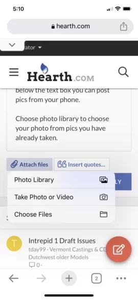

Thanks for the manual link. Can I post photos here from my cell phone? I'll get the front easily enough but the back is against the original field stone fireplace and the sides don't have a lot of clearance. If it did need some work it would need to be taken out of the fireplace to be able to work on it. I'm at the camp now but don't have my camera and those photos I know how to post. I am iffy on cell phone ones.
Now don't laugh...too much...but last September, at age 68, I got my first cell phone. And only because I had to because of the 4G thing.

If you use the attach files button below the text box you can post pics from your phone.
Choose photo library to choose your photo from pics you have already taken.

Thanks. I have a Pixel 6A through Verizon. So far I was able to "share" my pictures to my gmail. I went to gmail and they are there. The only thing I see in Google pictures is another share button which I don't want. I was looking for a download option but don't see one.

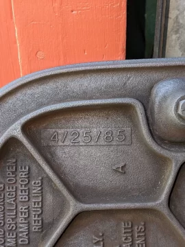

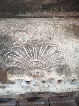

FYI, on the bottom of the top loading cover there is a lot of areas and instructions. One area is stamped 4/27/85 so I'm thinking there is the DOM date.

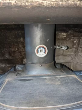

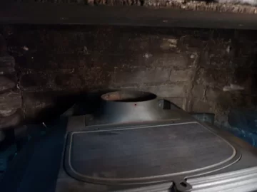

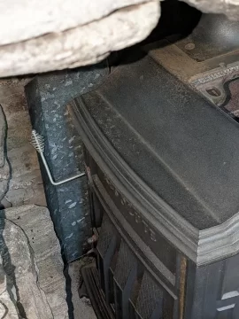

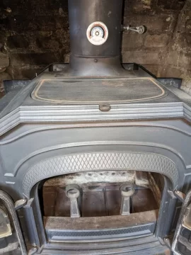

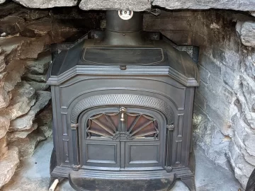

PXL_20230527_150038569.jpg PXL_20230527_150334130.jpg PXL_20230527_143722725.jpg PXL_20230512_184048390.jpg PXL_20230512_184003549.jpg PXL_20230512_183954296.jpg
VC Resolute III
May 26, 2023
22
Lempster NH
I think I did it. I have other photos but these give a decent view. So, if 1985 is correct my FIL passed in 2005. He did not go to the camp in the winter so his use was early spring and late fall. My wife doesn't believe it was heavily used.

Yep, that works. Welcome to the digital age. It looks to be in pretty good condition. Is there enough clearance to topload it? Does the bypass click solidly in place when closed? I'm not sure how well the thermostatic air control will work in the closed fireplace space. The radiated heat will throw off the bimetallic. How much is TBD.

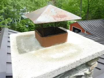

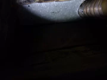

Indeed, the only stove pipe is the one that exits the stove and up into the beginning of the chimney, perhaps 2 feet. Then it does "dump" into the original 8"X12" clay flue up to the top.

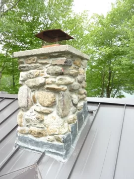

The chimney cap is only a flue cap and is woefully undersized. A full size chimney cap is needed. That's the easy part.
The flue is old and deemed "don't use it" A stainless steel liner is indeed recommended. That's the expensive part. Likely gonna scare the hell outta 3K when all is said and done.

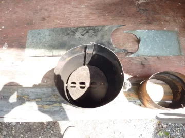

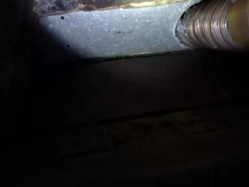

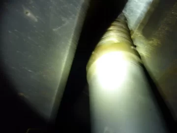

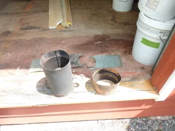

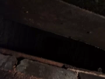

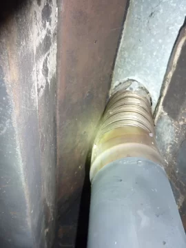

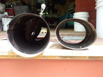

Well, I pulled everything out, made quite a mess but I had to do it. Old school installation, just a dump pipe, poorly installed. But I have a clearer picture of what I am up against.
1. It is not a straight shot from the top down to the stove. The stove discharge is about a foot in front of the flue. The flue is closer to the rear of the firebrick. So looks like I need to go the flex pipe route.
2. The factory stove collar is slightly oval. 6 7/16" left to right and about 5 1/2 " front to back. Picture 7.
3. Picture 8 is the damper opening, best shot I could get. The damper opening is roughly 30" long and about 51/2" wide. It looks like they stepped on the dump pipe to make it oval to fit through the damper opening.
4. Picture 9 shows the pipe with a damper handle that slipped into the stove collar. They made it slightly oval to fit into the collar and it's a problem. The hand damper is 6" round. By stepping on the pipe to get the dump pipe collar to slid onto the top of this hand damper pipe being oval pinched the 6" round damper plate and it wouldn't move. My FIL likely turned the handle to get it to move but all that did was to cause the handle to separate from the round damper so the handle just spins and the damper doesn't move. I don't know if this pipe was factory of if its a run of the mill stove damper pipe? Whatever the case I need a new one. Picture 10 shows the inside of the pipe. The rod handle just spins inside the flapper
5. Picture 9 also shows in the background the 2 pieces of sheet metal used to go around the dump pipe and to seal up the opening. Problem is it wasn't sealed and had gaps all around it
6. Picture 11 is another view of the damper pipe and the sump pipe collar.
7. Picture 12 is the dump pipe. Stepped on to make it oval and is about 60" long.

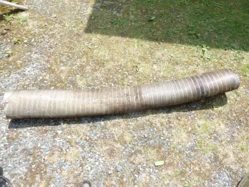

Your thoughts and opinions as to what I need to do to get this back up and running would be greatly appreciated. Lowering a flex pipe seems easy. I need 17 feet. I think the top pipe should be a rigid pipe so I can put on a stove cap on it.
The oval connections pinching off the round damper pipe I am not sure how to handle. I could take a sawzall and open the damper plate a bit to accept a 6 inch round pipe? Also the sheet metal placed over the damper hole is poorly done and not sealed and I would like to give that location the attention I think is required.
Also, only the top of the is outside (5 feet) 12 feet is inside the camp. Should I skip insulated pipe or is it still worth the few extra bucks?
Thanks again.
Harry

Additionally I am having a hard time finding a adapter for the stove collar oval to the 6 inch round to accept the pipe liner.
I have had dealers tell me the Resolute III did not have a oval collar yet although it isn't much of an oval it is oval non the less. About a hair under 7 inches wide and about 5 1/2 inches deep and a little over 19 1/2 inches in circumference.
I have been told it's not a Resolute III
I have been told because of the double doors it is a Resolute III
Were versions I and versions II still made in April of 1985?
