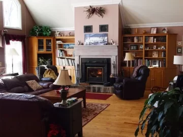

About the photo: This is the Winterwarm installation in our great room. The mantle is hard pine and was taken from an old house on our property which was built about 1850.
