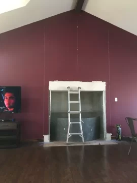

so we recently pulled out the old fireplace we had and are installing. A wood burning stove. We have met all specs and are now about to start with the stone. We are going to be applying cement board over the drywall into the studs and also using liquid nails just for extra support. Will this be strong enough hold the weight of the stone?

Is there a reason why you are not removing the drywall first? Liquid nail or not it won’t change anything because gluing cement on carboard doesn’t make the cement much stronger
Follow the manufaturers instructions
Might want to read all of the label on Liquid nails. believe it has a heat range which the proximity of the stove will exceed
You might want to check and make sure your foundation is solid. Is there a basement or is this right on a slab? You are talking about thousands of pounds. Worth checking into. It looks like that is an outside wall...so you're likely right on the sill plate right there. Thats a good thing.
Putting that up on sheetrock sounds like a horrible idea. If it was me, i'd tear that out and put up cement board.
To do my cultured stone wall. I first covered the sheet rock wall with stucco wire mesh. This created a good base for the mud to adhere to. The screws holding the mesh went into studs. The nice thing was this didn't add any thickness to the wall.

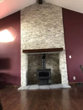

Got into all done! Got the double walled chimney in and caulked and just got all the finishing touches done. It says I need to do two 20 minute 250 degree burns anyone know what’s the best thing to burn in that amount? Some thicker sticks I would assume
