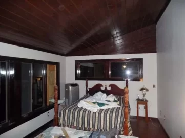

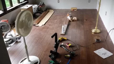

Well I been busting my hump on the main house the last couple years, finally getting headway. I started one room at a time, but that was taking too long, and since I am the only one here, I jumped all over and the house is a disaster zone. But getting things done.
Master bedroom before & after, have to clean and get rid of crap I'm storing in there when I get the loft done.

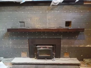

I had to halt on the loft & flooring up there, to get the fireplace brick covered FINALLY!
I got the lath up today. Got a great deal on real stone veneer panels on Facebook market, and hope to get started on that this week or at least next weekend. I Have enough bamboo flooring to do the entire house except for the areas tiled. Carpet is all going or soon to be gone. Needless to say, I am burning oil at the moment. It is hard not to light a fire, I am fighting a primal urge LOL. But hopefully in a couple weeks the stone with be up and fire blazing. One photo is the stone setting against the wall with the flooring. Will be sweet when finished.
I tried to use paint remover on the hearth. Some may remember the gray paint on top, and the copper paint on the edges. Well after trying to strip, no go, wire wheel, no go, got a poly wheel at harbor freight and wallah, down to stone. I used a brass wire wheel on the edges and it got the paint off and gave it an almost steel looking color. May just seal as it, or stain & seal. The mantle showing is what the heart used to look like. I will also be covering the wood mantle with a distressed wood mantle which will be boxed over top of the stone mantle. Right now, just want to get the stone on so I can fire the bioch up.
Oh, the gray on top of the hearth came off with stripper and a scraper, but there was copper paint underneath, stripper would not touchy it. The poly wheel did. I dusted the entire house out LOL. Good thing the lil woman isn't here to see that.

Well, I was going to buy a live edge slab to rabbit out and set over the old flagstone mantle. Slab was $75.00, not bad at all, but the lumber yard was not interested in routing out the bottom so I could set it over the old stone.
I decided to build my own mantle beam. Did a little research(beauty of the internet) and went to HD and bought two 1" x 10" x 10'ers and a 1" x 6" x 10'er. all pine lower trim grade boards. I like knots and such, and I am cheap, so it worked out good. About $49.00 if I remember correctly.
Should have done in progress shots, but started at about 8pm on Friday night and finished the installation about 9:00 am the next morning, straight through.
I cut the boards to length, then cut 45s on all the edges that would meet. I had an Oak round slab cookie about 2" thick by 20" or so diameter, and cut two ends for the beam out of the oak. 45'd the ends to mate to the pine ends. I wanted an end grain on the ends to make it look more real, and feel I accomplished that. Installed all together using Gorilla wood glue & 18g brad nails.
I did have to pack out the old hearth o top with 1/2 wafer board and 3/4" masonite to get eh 5" thickness. Attached those to the old hearth with tapcons, screwed the new top at the back which will be covered by the stone veneer. And went up through the bottom new bottom board with tapcons into the old stone hearth also.
I then took a 1" chisel along with my 5" orbital sander, and distressed the new wood beam. Adding wear tot the edges, a few insect tubes etc. Even took a screw and punched a bunch of small worn holes at the "bug eaten" edges I made. I also used the orbital to ground out around a couple front knots to accent the knots. A few hatched marks, screw marks etc. Lastly I chiseled 2 channels on top to give it that used wood barn beam look.
My first beam, and I surprised myself, as I am very happy with how it turned out. Looks like a real beam. At very close up, if you look hard enough, you can see a faint seam where the 1x edges meet, but overall, I love how it turned out, The satisfaction of making it and how well it came out is a really good feeling.
Now I have ideas for vertical timber beams all over the walls LOL.
Stained it Dark Walnut, and put 2 coats satin clean on, 2 more coats of satin to go.
Dimensions: 8'8" long x 9-1/2" deep x 5" thick
Attaching a pic of the old stone mantle as the before photo.

I made the cracks with a knife and chisel.
