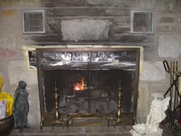

Here is a picture of our fireplace. The house was built in 1958 and the fireplace is original. I've seen other pictures of similar fireplaces with fans in the vent holes. Where do you get fans like that, I've looked all over and can't find them? The fireplace puts out a lot of heat from those vents and it would be nice to have fans.
We are looking into an insert, probably a Hampton HI301. Is the HI301 the big brother of the HI300? The firebox opening is 38"w x 31" high (ignore the tin foil, just trying to cut down on the smoke). I've heard Hampton's are good, but they're really hard to get right now (no surprise).

What I don't see is an air intake. Is there something I'm not seeing?
Most fan motors aren't rated for much over 100 degrees, so anything you put in there will be kind of short lived. If there is an air intake down low, I'd put the fan in there.

The fireplace has a metal firebox and a second box surrounding the first one, with an air gap in between. The vents are in this air gap. It's like a box inside a box, the fire heats up the inside box, which heats up the air surrounding it and the vents then allow that heated air into the room. The inside box is sealed, so no fire or smoke gets into the air gap, only heated air. If I look into the vent, I can see that the gap surrounds the inside firebox, but I can't see completely into it, so I'm not sure if it's tied into the chimney or anything for an air intake. All I know is only warm air (warm like a hair dryer warm) comes out the vents, no smoke, and if I could draw more air from those vents, I could get a LOT more heat into the room than just the ambient heat from the fire.
Ok, the air has to come from somewhere and those vents around the edge are the intakes. Most prefab fireplace fans push the cool air into the outer shell and blow it out the top openings. You can suck the warm air out the top, but most fans can't handle heat over about 100F or so.
If you want to try something, look into computer type muffin fans from Grainger. A 4" fan is probably $20-30 or so and could be attached to the inside of the existing grille to blow out. You'll have to leave the wires exposed on the outside which isn't pretty and they may not last forever, but I don't see any harm in trying it. Don't be surprised when the air temperature drops off though. An open fireplace isn't going to give off a lot of heat, except up the chimney.

If those openings are intakes, shouldn't they be lower? There are no other openings, so my guess is the they are just vents and not intakes or exhaust. Maybe the idea is if you suck air out one opening with a fan, the other opening acts as the intake. Both openings are connected around the inner shell, so that would make sense. Yes, the temperature will drop, but if I have a low RPM fan, it shouldn't be too bad. If I put a hurricane strength fan in there, it will suck the air out faster than the fireplace can reheat it and it will blow cool air after a while.

Most setups like this I have seen have had a vent on the top and bottom on each side. Hard to say how the air circulates here. Id blow some air in one vent and see if you can find where it comes out.

I doubt the air coming out is over 100 degress. Doesn't matter since inline duct fans are rated to 140+ degrees The air at the ceiling above my wood stove barely reaches 100. Get inline duct fans from Lowes, etc.. of appropriate size. You will need make a cord to plug it in. YOu can go with the cheap duct boosters or go commercial. You will need to be very careful that you don't pull smoke or carbon monoxide from the fire box. First task is to figure out were the intakes are.
