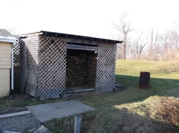

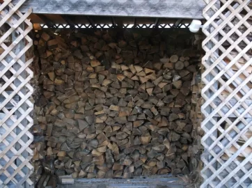

This is on top on a hill and the wind blows through it, No problems with rain or snow to report
  • [Hearth.com] vented sides on wood shed?
