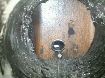

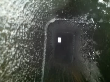

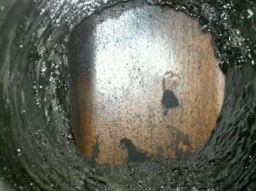

I've attached some pics i took looking through the thimble. Looking like there's not just "brick" in the chimney. There's concentric rings, about 6" tall going around the chimney all the way up. From what i understand, house was built in 87 but chimney was added later, 92 or 93.
So, i'm "hoping" that tiles mean that chimney may be able to handle stove load better without liner? Here are pics (first is camera phone directed up chimney shaft, hopefully better illustrating the "rings" i was talking about, 2nd is my little makeshift mirror to check shaft, third is looking through thimble)

LOOKS LIKE TILE TO ME ,THATS OK FOR A WOOD STOVE , BUT I DONT KNOW MUCH ABOUT PELLET STOVES,I DONT THINK THERE WOULD BE ANY CONCERN ABOUT IT GETTING TO HOT,BUT THERE MAYBE OTHER CONCERNS WHEN HOOKING UP A PELLET STOVE.LOOKS A LITTLE DIRTY!
If anything, i think a pellet stove exhaust is lower temp than a wood stove but hey... i've been wrong all week.
So, if it's tiles, temperature isn't going to be as much of a concern? I think draft/cubic feet of stack to warm is going to be a problem and that's where the liner would come in. If i end up putitng the pellet stove in there, don't want to blow out the blower if there's too much resistance/not enough draft.
The Europa has a very low stack temp and low cfm convection fan. Because it only uses a 10 to 1 air ratio, there just isnt a lot of muscle to push that exhaust very far. That being said, I do have one customer with a Europa into a 20' or so masonry chimney thats working just fine. The other ones all required 3" stainless liners.

Looks like a good chimney to me. I have both my pellet stove vented directly into masonry chimneys with no problems at all. The chimneys require very little cleaning and no cresote issues, unlike a wood stove. Don't be to concerned about draft, you are going to gain lots of natural draft from the height of the chimney without the aid of an exhaust fan. Think fireplace. Good luck!
Reactions: Brendanschuler
Tile lining good, not so sure about what is on the surfaces however, as it looks like creosote.
Was that flue used for a wood stove?

All that build up is likely glazed creosote. What causes that? I was cleaning pipe out weekly... i'm convinced that the CSL log i used is what induced the glazing since i didn't have that problem until i ran that (once... and only once).

From the pictures, it looks like your chimney is already lined. I assume that it's a brick chimney with cement liner sections stacked all the way to the top. You probably could safely vent multiple pellet stoves into such a chimney. One thing to be aware of is broken, cracked, or missing sections of the liner. My chimney has that problem but it wasn't a problem when I used my fireplace (worthless) because the brick chimney was as good as new.
