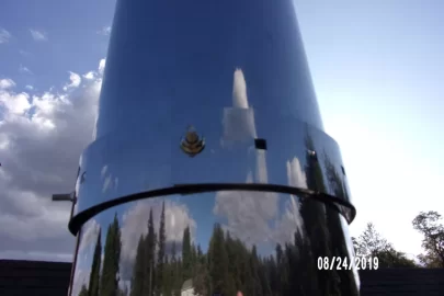

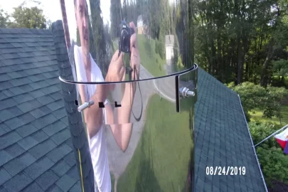

Question guys: Still messin with this (got delayed due to weather). Went to install roof brace (rods) and the bands that go around the pipe aare still loose even after I tightened the bolt the whole way. So the bolt is now bottomed out and the band is still loose. ;? [Hearth.com] Ventis cathedral box/adapter junction...silicone?

Well I got it. Seems like all I had to do was move the one flat-backed-carriage bolt around the strap to another, different hole that then allowed the band to tighten. Sometimes when ya rush to beat the rain, you miss the little (important) details.;em
