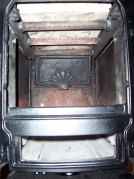

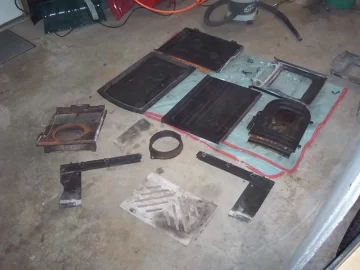

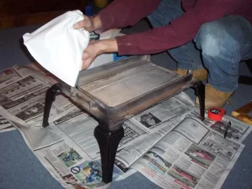

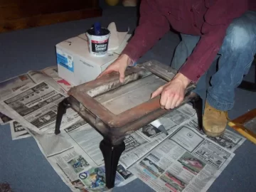

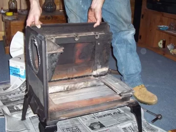

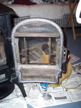

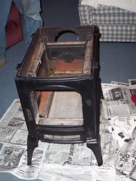

I promised a detailed writeup, and its on the way. Too busy right now to really get to it. Here's some snapshots of tear down and rebuild though.
  • [Hearth.com] Vermont Castings Aspen Rebuild Pictures

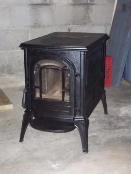

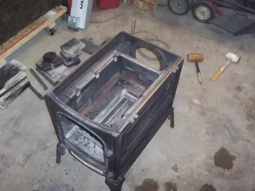

Finally done!

Very nice job, Corie. Please tell us what you think when you fire it up!
:) tee hee
You just leave my little stove alone you heathen!
And BTW in case anyone can't find the furnace cement in the caulk tubes. You'll see me using a grout bag with the tub of furnace cement. It takes a little effort to squeeze it out, but it works very good and dispenses almost the perfect amount of cement into the channels.

The secondary tubes on the Aspen look awful big for that size stove...
I agree.
But the holes that feed the tubes from the cast iron secondary risers are probably half the diameter of the actual tube.
We'll see how it burns. Once it gets warmer, it will be on the test bed. I'm really glad, at times like this, that I installed with lots of flexibility in the verticle and horizontal directions. There is almost no stove I can't hook up because of the pipe setup and the monster hearth I have.

Also was that a pastry bag full of furnace cement?
I have an aspen and might want to do the rebuild this summer.
I just reverse engineered it. Looked at the parts diagram a few times to get the order of reassembly figured out in my head. It's pretty simple once you start rolling.
Also, yeah that's a grout bag which looks just like a big pastry bag filled with furnace cement from the tub. It costs about $4.97 at the Home Cheapo and if you rinse it out, will last for a while.
I highly recommend doing it this way.
Coaster that reminds me.
Those gaps you were talking about. I wasn't sure what you meant until i had the stove apart. I can't figure out what their purpose is, and the previous owner had stuffed some gasket material in them to close them. Or that gasket material had been put there at the factory.
Either way, I replace it with fresh. Those seem like a casting error, and I don't see how adding room temperature air at that point of the smoke path would do anything but dilute the secondary burn.
