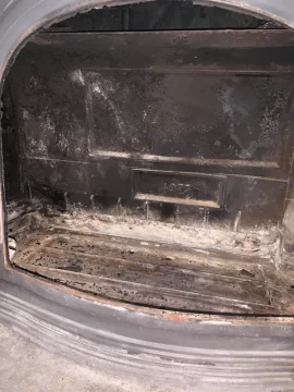

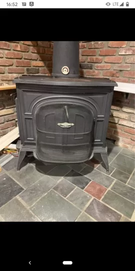

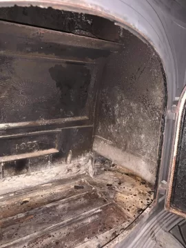

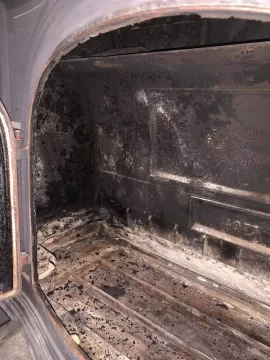

Hello! I'm looking to get into the wood stove life and have found a used Vermont Castings Defiant that I'm hoping to purchase. Looking for some guidance on if this looks like a stove in good condition, and worth investing in.

It's about 40 yrs old, but they were good stoves in their day.

Looks like its Defiant 1A with two piece fireback that looks in good shape from what I can see. I have twin in my basement. It is the original VC design that built the company. Its was designed for drafty old Vermont homes and tend to be overkill in a single room application unless its a really big room. They eventually came out with two smaller desings that fit in a typical house better. They are more efficient than a typical "smoke dragon" when run in bypass mode if the secondary air tube is clear. There is a hidden chamber behind the fireback that is a PITA to clean. The manual is available to download that shows you how to get to that hidden chamber. If you operate it with the front open, its not very efficient. Like any older cast iron stove, its sealed with refractory which gets brittle with age. Its likely that the refractory could crack when you move it. Resealing it is not that hard but it takes time. Getting the secondary air sealed is PITA. Its two C shaped rough cast iron sections that sort of mate up in hard to get at spot. The two faces are buttered with refractory then a piece of metal screening is laid on top one the two sections are facing each other and in place and then refractory is buttered down onto the screen and smoother out to form the bottom of the hidden chamber I mentioned, do it right and conduct air along the back of the fireback and its preheated and introduced into the secondary burn chamber on the right of the fire box . Do it wrong and seal it up and the secondary air will not work. Put the refactory cement in too thin and it leaks up into the hidden chamber.
They are good old workhorses with good rep but the design i close to 50 years old, newer EPA stoves are cleaner and more efficient. If you want to install it in a house with insurance make sure there is a rating tag on the back usually the lower left hand corner when looking at the back. If the rating tag is not there many insurance companies will not approve it.
It also requires an 8" diameter flue and unless you have ideal stack draft it may not run when connected to a 6" flue.If your need to put in a reducer on the outlet stove pipe to fit the thimble, its probably not a good fit.
Stove prices vary by area and heating costs but a Defiant in good shape with a good fireback is in the $500 to $600 range. This one looks in pretty good shape so it could go a bit higher.
