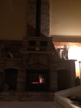

I posted last February about this. We have been in our new home about a year and a half. We have this awesome solid brick fireplace built around a Vermont castings fireplace system with a large winterwarm in it. It has a crack in the right side of the firebox. I had someone come look at it and they said parts are not available and it was small enough to use furnace cement on it. So I did and the stove works fine. We only . use the stove on the weekends. Anyway looking to the future I need to find someone with parts that. An overhaul my stove or replace it. I do not want to tear apart this solid masonry set up. Any advice is appreciated, and or information.
So there is no way to gut it without messing up the brick?
Since this is a “system” you really won’t find any info saying that it’s ok pull that VC insert and replace it with a different one. I would agree typically, but your install looks to be different than most. Typically it’s built into a combustible wall, not solid masonry.
Are you certain that there’s no wood in that structure?
Nope. It’s a big metal cabinet behind that brick.

99% sure there is no wood. I am going to contact the original owner of the house to try to verify but yes it's. It face brick at all it was built by a mason.
I'm no expert but that seems dumb to me. No matter how well built, things wear out right? So why was this not thought of during construction and the appropriate measures taken so the unit could be replaced if needed or desired? I'm not expecting you to have all these answers obviously, just asking anyway.
The winterwarm insert comes out. But there is a steel cabinet it sits in inside the brick that is permanent. It catches all the heat from the stove and sends it out the vents above the stove in the brick. It wasn't put inside an old fireplace.
I see. And the crack is in the insert correct?

Since this was a VC system, only their insert was approved for it. Like I said, I doubt anyone will actually approve their insert for this application, although it would be fine.

There isn’t really a way to connect it to the existing flue. The insert currently has a big oval section of flex that attached to a class A chimney in the top of the cabinet. Running a new 6” liner would be a must.
I also like the idea of a hearth stove rather than another insert. If it would fit.
Well there is hope! The local fireplace/stove store says they can get the panel I need. It is special order and no returns but supposedly they can get it. I gave them the model number, serial number, and date code. So I hope when it comes it is correct. If so the stove is fine with the furnace cement, it should be good for this winter. Then in the spring I will tackle replacing the side panel. Anyone ever take apart a winterwarm?

Hello, well I still have this stove and am now seriously considering changing it. It needs a new refractory chamber along with the catalyst, then resealing all the inside panels. It will have to be pulled out to remove the secondary air probe that goes into the refractory chamber. While it’s out I should change the right side that has the small crack. So adding up the parts I’m at $1,000 plus. So does anyone know a good replacement that is similiar that will fit in it? I have since spoken with the original owner of the house and she confirmed it is solid masonry surrounding the fireplace system. There is 1 course of brick behind the steel cabinet in front of the wall. The cabinet is completely surrounded in solid masonry. Or if it cannot be done what would it cost to have someone Remove the insert disassemble it and rebuild it? I’m located in the southwest suburbs of Chicago any info is appreciated.
Well I ordered most of the parts, the combustor chamber wasn’t as bad as I thought so that saved a lot. Got job weld high temp epoxy and took care of the crack that I have known about for a few years now. Re-gasketed the upper fire back, bypass damper, lower fire back and air intake plate. Also installed the missing nuts and bolts that hold the upper fire back in place, and tightened them down tight they were not in place before so when I took things apart the upper fire back just fell out. This stove should burn a lot better then before hopefully. Also how tight should the two upper fire back bolts be? They weren’t in so I had no reference when I took it apart. I tightened them down tight with a 1/4” ratchet.
