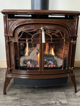

I finally got my fireplace up and "running!" The biggest faux pas I had (which prevented the pilot staying lit) was that I was not connecting the wire from the valve to the thermocouple. Live and learn I guess. Also, I have to keep a jumper wire attached since there is no on/off switch with the unit.
