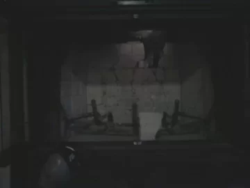

Hello all, this is my first post as I am new to the forum. The firebrick rear liner in my 2.5 year old wood fireplace insert exploded the night before last, it now has a section the size of the average grown mans hand missing from it, as well as spider web cracking all throughout it. We typicaly have 20 or so fires a winter, for 4 or so hours at a time, and have only burned maple, ash, and an occasional locust log. To say that we have had 50 fires total in it would be a stretch. We contacted the general contractor who built our home, who refered us to the mason who installed our fireplace, his response , was that this is normal for an insert fireplace to go through a full set of firebrick in 2 years, I think it is BS. I know that the warranty period covers the fire brick liners for 2 years, but the amount of deterioration seems extreme to me, as well as the fact that only one is showing cracks and peices missing. I am hoping that some owners of similar products will post and tell me if their experiences have been the same and this is in fact normal or if this panel sounds as though it may be defective. Thank you, sincerely, Ryan Exum

I have the big brother to that fireplace, my back panel has cracks but doesn't seem to be in danger of "exploding". In the prefab I replaced with the Ultima, I burned maybe 5-6 cords a year for 2 years and the panels mostly held up. So I'd agree it sounds defective but that's not going to help you any.
Call VC direct. Sounds like a warranty issue to me. I've seen those refractory panels hold up in Majestic and other brands for 15+ years. You can also repair your refractory with refractory cement until the replacement comes. Also if the mason is the one who sold you the unit and is refusing the warranty service let VC know about that too. If the mason bought it from someone else then contact that dealer and try to get a new one that way.
I will contact VC tomorrow, here is a picture of the rear liner, sorry for the poor quality, but it gives you a pretty good idea of the extent of the damage. I will keep everyone updated on how I make out.
