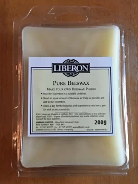

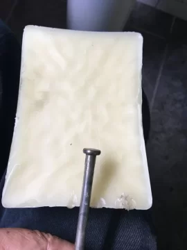

research in the carpenter world, I discovered pure beeswax available at Rockler. I said to my Honey, I will try the Bees Wax!
Purified Beeswax | Rockler Woodworking and Hardware

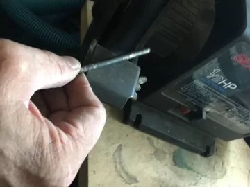

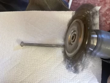

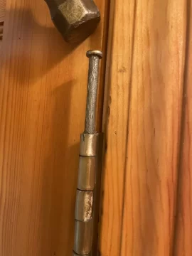

So I banged out the pins and buffed them up and I am giving the Bees a chance? The wax is very hard and may last quite a while!

Pic 1 - Pure BeesWax (not exactly the one pictured on the web site but the same price! :))

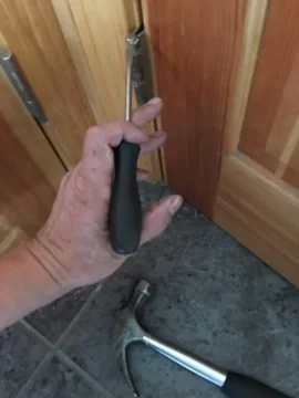

Pic 2 - Bang out the hinge pin
Pic 3 - buff pin clean on wire wheel
Pic 4 - add BeesWax and push back in. :)
So far no squeaks :)- see vid 2

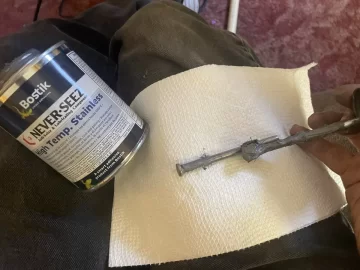

The Bees Wax was an old carpenter trick that did help for a while. It does pick up dirt and gets harder. So now they are back squeaking again. So this time I got something more binding! Not the cheap generic brand, not the name brand bargain can, not even the middle of the road works in many cases brand! I pulled out all the stops and went all in on the top of the line Premium High Temperature Stainless Steel Never-Seez!!! Maybe this time, for the first time, we will win??
Pic 1. Clean
Pic 2. Paste
Pic 3. Install
Hopefully this will make for a nice quieter Memorial Day weekend! LOL
