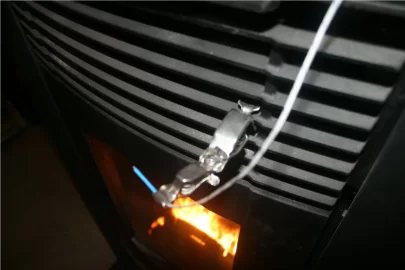

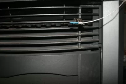

Thanks for the info Jay, I'm still learning, and this forum is helping. My wife wants the cabinet moved up to her closet, so I will be getting that out of the way soon. I'm still sore from moving a ton a pellets myself yesterday, so I will be waiting for my bother-in-law to help me. I use the IR thermometer to check the temp. at the exhaust and I check at the same spot each time I check it out. How do you get your temp. reading for the pellets you test. I know most of your readings are around 250* is that from a certain spot on the stove?
I have been measuring the air off the convection blower. I measure just the heated air from the blower, Not the stove temp itself. But it doesn't matter as long as you measure it the same way each time. One thing I have learned is that you want to keep the stoves exhaust as low as you can and the convection temp as high as you can. This keeps the stove burning the most efficient
My stove is a beast and eats alot of pellets. That why you see high convection temps.
