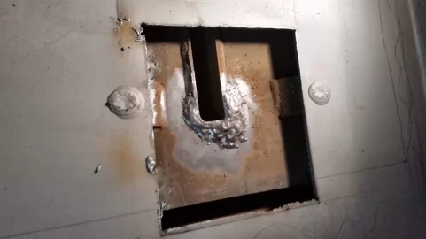

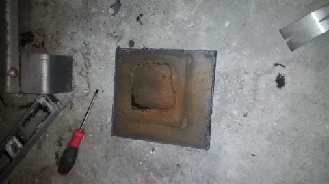

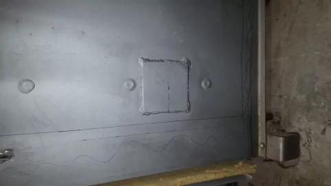

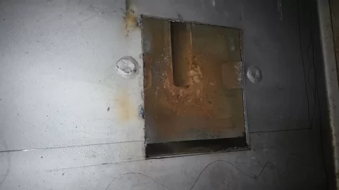

As you can see a patch was put on to access the water jacket through a torched out hole and then very poorly welded, keep in mind when I got this boiler it was "new" never fired,

Thanks for the photos, I was kind of morbidly curious. If it's just one defect with a botched repair then it looks like it should be possible to cut away some more of the jacket and get in there to grind away and do a proper repair. The quality of the other original welds seems reasonably good from what we can see.
IMHO I would use the opening you have to grind down that mess with a die grinder and carbide burr. I would then cut out a U shaped plate that would fit around that air passage, weld it up and bam you are done. Or have someone do it for you if you are not comfortable. Looks like a pretty easy repair if that is the only leak.

I wish it was the only leak I ground it down and rewelded but still leaks I think it may be in a diff spot and they thought they were fixing the right area the first go around, extremely hard to tell once you cut into the jacket because you now have no way of filling with water to find leak, any suggestions
Just an idea, maybe drill and tap a few #10 or 1/4" (fine thread?) holes around the opening and bolt down a temporary gasketed plate with cap screws. Then pump in a few psi of air and soap up everything with a bubbly detergent and see what you can find.
I like the temp screw on cover idea. That way you can make sure the leaks are fixed before you weld it back up. Might want to fill it up with water and then pump in 20psi or so.
