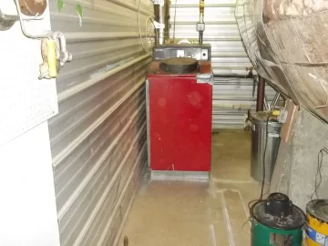

This boiler burned 22 cords a year .
The Jetstream with storage burned 4 cords a year!
Over 35 years that's a difference of 630 cords!
