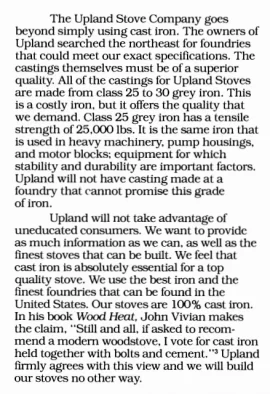

At Upland, we actually advertised the class 25 and 30 on our spec sheets - this is from the dealer handbook.
[Hearth.com] Virgin iron ore - or recycled?
Even residential cast iron boilers are only tested to 75 PSI or so and run at 12-15.
