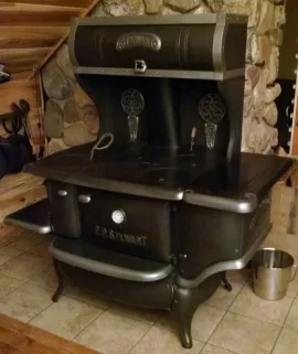

This is our other "new" cook stove, restored and fully functional; even cooked the entire Thanksgiving dinner this year. Would love to know more about those P.P. Stewarts if anyone has any information.

Now ya got me hungry for the biscuits Grandma used to bake in a wood oven.

The sawblade hearth is awesome!
This is how it looked when we bought it. We unassembled it entirely, sandblasted every piece then put it back together, resealed, painted and polished it. The warming oven, ash pan and water jacket had to be fabricated as nothing was left to work with. Nickel plating was not in the budget but maybe someday. The tolerances and attention to detail in the casting are amazing.
